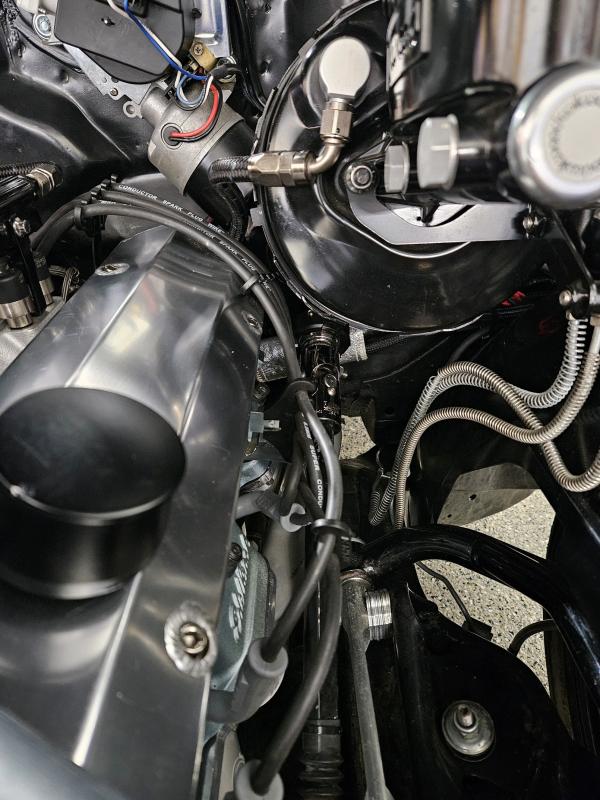

HWYSTR455's Avatar
Location: Winchester, VA
Posts: 16,206
Originally Posted by grivera View Post
I assume you have the tall aluminum fab’d valve covers- if so how is the clearance at the booster?
Yes, and have the new Ames engine mounts, which raise the engine by @ 1". The clearance from cover to booster in the closest area is about 2".
I have fuel rails too, but just need to kind of turn the cover towards the intake during removal and it comes off with no problems.
EDIT: Added a pic of the clearance with the Anchor engine mounts too, but you may have to zoom in.

This is great Mike, thanks! Any issues removing valve cover?
Sorry I missed this, but no issues removing the cover, as long as you don't get impatient. Like I said, if you lift up slightly and turn the cover lengthwise towards the intake, and then lift up, all is fine.
If you get impatient, worst case, the gasket will get pulled off the cover if you glue it to the cover.
