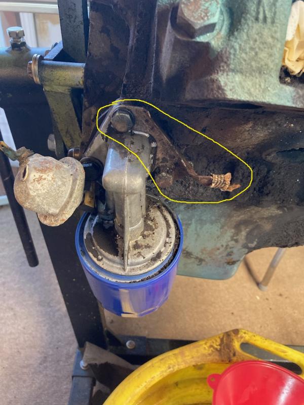

I removed the engine from my 1968 GTO with 45000 original miles on it for a rebuild [cam wiped out] and noticed this brace on the oil filter housing.
Is this a factory item?

Yes it is. That's a stop for the exhaust manifold heat riser valve. The right side manifold with the valve was replaced with a regular manifold in production sometime in Mar-Apr 68.

You are the 68 GTO man.
That makes sense, I did remove the stock [cracked] manifolds and the valve was frozen open.
Time to order Ram Air exhaust manifolds.
thank you for the info.

OG,
So they did away with the heat riser valve in early 68?
There was nothing to encourage exhaust flow through the intake?
I had no idea. The set of manifolds I have on my (April 68) GTO have (had) the riser, but they are not original to the car.
I removed it and plugged the holes.

My 68 GTO was born in 11/22/67
Great info, I should put my bracket in a glass case, so when someone wants to build an early 68, I got what they need

I wonder if the manifold cracking in that area was also a reason to discontinue the heat riser? Mine was cracked at 45000 miles or earlier.

So with my YS 789663 engine I've got the wrong RH exhaust manifold, I should have one with no riser.
I assume the "heated air intake system" mentioned is the tube from the air cleaner snorkel to the heat shield thingie on the left side exhaust manifold.
Old 09-29-2025, 11:19 PM
OG68 OG68 is offline
Posts: 1,923
What's your EUN Data?
549847 and above will (should) not have the riser valve
Yes, the cardboard hot air tube.

Engine number is 789663.
When I got the exhaust manifolds I remember thinking that I didn't remember my GTO originally having the riser, but then that was like 50 years ago
