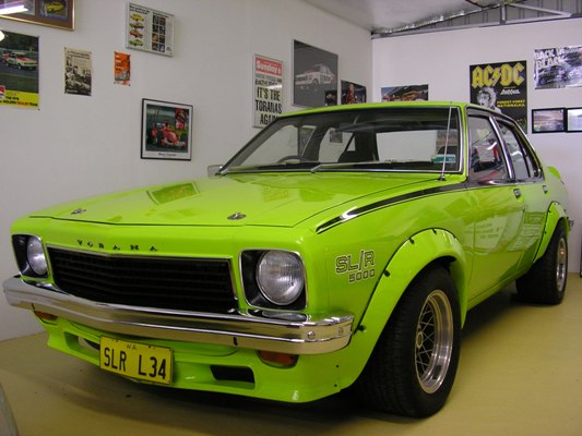

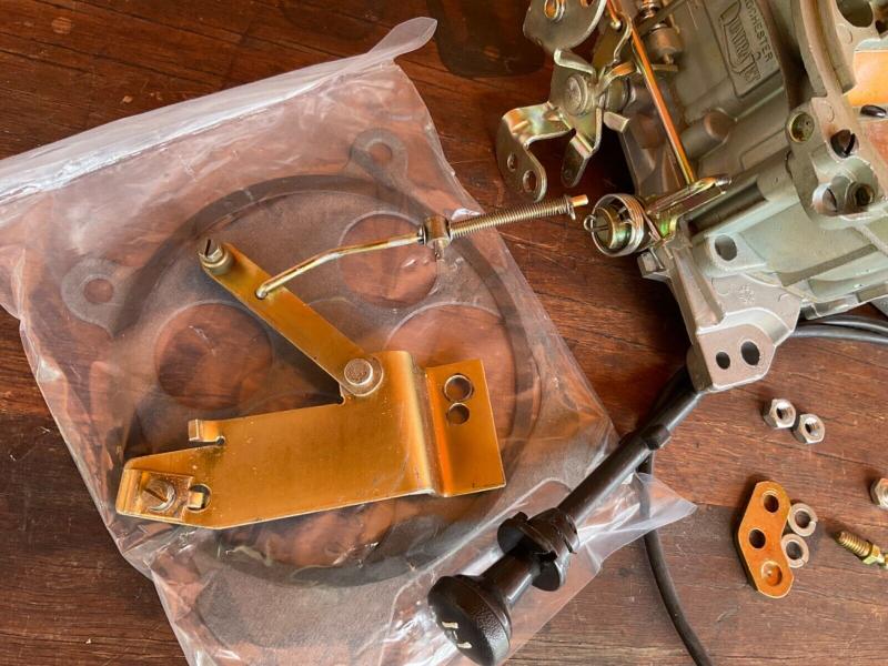

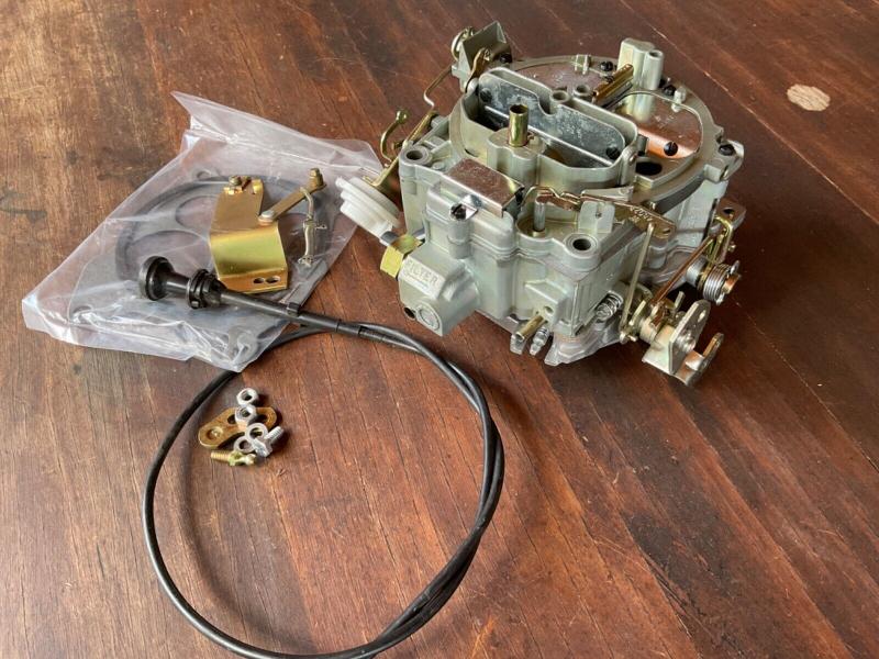

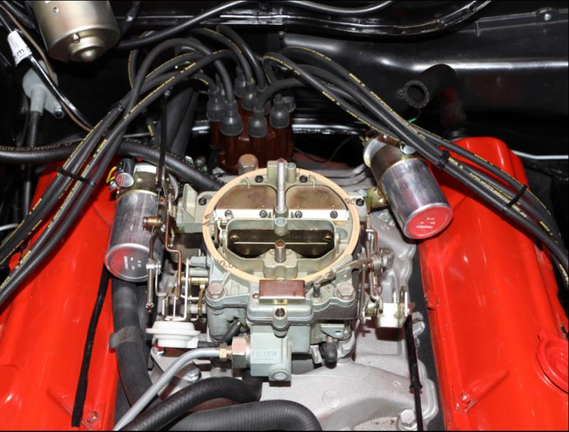

The GMH built Holden Monaro's that were factory fitted with Chev's between 1968 and 1975 used the 4MV (Divorced choke) while all Holden V8's (308 CI) used the 4MC. All Quaddies fitted to Holden's had the number 8 for the sixth digit of the part number.
The 1974 L34 Torana was fitted with a manual choke from factory. This was a limited run of 263 cars to homologate the model for racing. I don't know if the carbys arrived in Australia already modified by GM or if the work was done here by Holden.

Does that L34 have dual ignition coils? Looks like distributor cap has two coil terminals.
