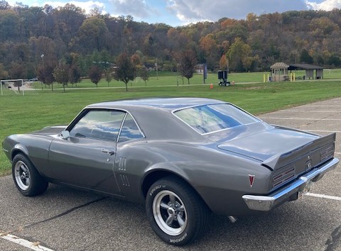

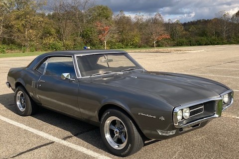

How is your car sitting, is the ass end higher then the front and if so by how much?
Forgot to reply here. The front was lowered before taking it to the track and the rear is the original height. This may not be the best picture. I recently installed a front spoiler.

In terms of my question you answered my reason for such was this.
When you start off from a stand still weight transfer to the rear tires does not start to take place until the car / chassis is at least level.
The higher your ass end sits above that then the longer it takes to plant the rear tires as well as can be had with a current set up.
