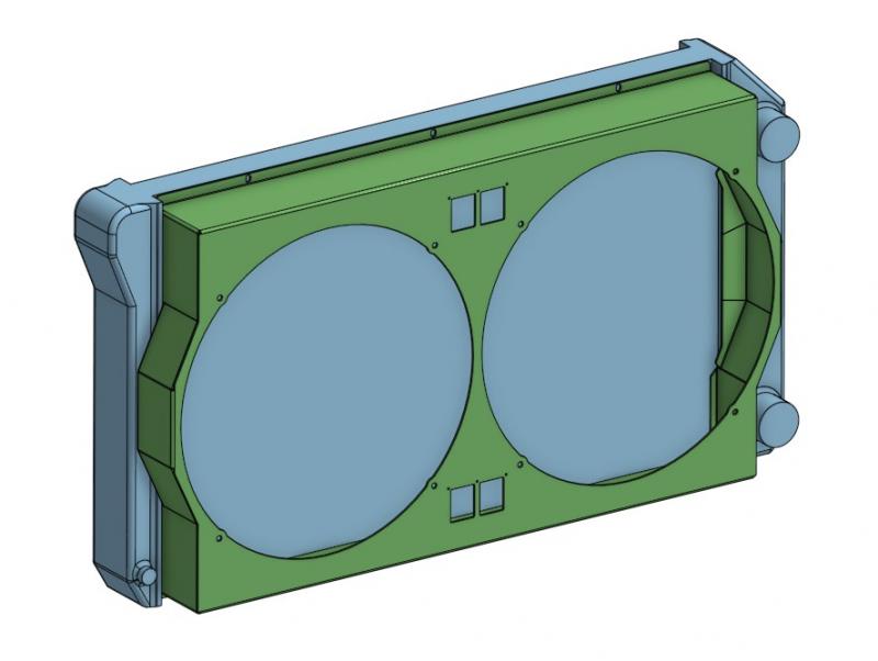

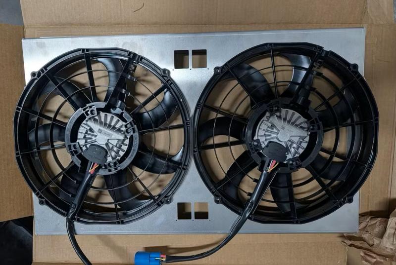

It's plausible, here's a rendering and picture of my first try at the A Body Shroud, for a FrostBite FB304 radiator, it's beefy. This customer was ok with welding the corners, as my next design needs to avoid welding. The F Bird core is 1" narrower. So, keep that in mind for clearance on the sides of the radiator would grow 1/2" on either side.
Attachment 667602 [ATTACH]Attachment 667604[/ATTACH]
If I decide to switch from a factory style clutch fan & shroud in my 535ci 70 Formula to electric fans, this is what I’d go with.
