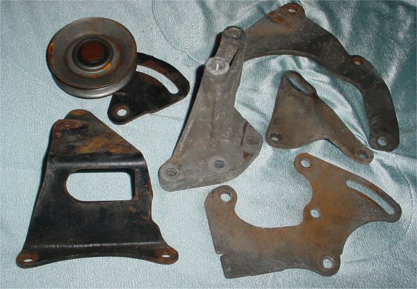

Is that an 80 amp alternator? Looks like standard size alternator?
The 80 amp ones I have seen are bigger than normal size alternators. Also usually used an idler pulley on passenger side.
Pic of a 73 bracket: (#6 in front of alternator)

Mike's pic has the idler pulley for adjustment.
You would need all of those brackets to make the PS bolt up also. (U shaped bracket at bottom)
Plus the idler pulley stuff on left side of pic.

The brackets with the pulley are what is on my 1976 Firebird. The alternator is fixed and the pulley is adjusted to take the tension. 80 amp is different than the others.
