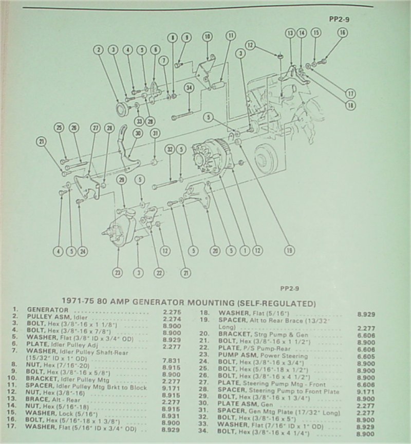

Idler pulley is for the alternator belt. I believe the pulley numbers are, Crankshaft Pulley 481038 YB (for A/C) and 480509 XS (A/C belt pulley) and Water Pump Pulley 481040 XT. I only see a casting number on the aluminum piece 485991 (I have the complete set off a '73 motor).

Are you sure this is for a 76 Firebird with the larger size alternator?
The idler is the same.
The #30 bracket I have doesn't have the adjustment slot. It's a non adjustable bracket. Also missing the #13, but have seen one of those somewhere in my storage extra parts bin.
My #20 bracket is different too?

OK, Ken. Do your brackets look like this? Of course, one bracket is missing, as well as all the bolts, spacers, alternator, etc. so I can't mock it up.

Thanks, looks like what I got. Just that the person that had this 76 I bought before me must have lost the spacers and had a bunch of washers where spacers should be. etc, etc.
No back brace for the alt. but then it had a performer intake and that bracket might not bolt to that manifold and he left it off.
I'll download the pics. Thanks again.

The 1st pic Held for Ransom showed is the same stuff he shows in his other pic.
You will need that #30 bracket if you don't need it.
They mounted the alternator sideways instead of 'up and down'.
They were mostly on A/C cars with electric windows and the rear 'de-fogger'.

John. The pic #30 shows an adjustable alt bracket.
His personal stash shows the same bracket I got. Non adjustable.
Once the Big alternater is bolted in place there is no way it will move. Have the engine out and fixing a pan leak in the car when I bought it so When I go back together I will check to see if the idler will line up with the alt. It was in the trunk with the A/C parts & brackets.

Ken. I assume you know the obvious, the idler bracket has the adjustment arc in it. As with the #30 bracket being incorrect, I also wonder if the #13 bracket is correctly pictured (if even needed).

BTW: the 76 Firebird 80 amp alt doesn't have the adjustable bracket shown in the pic, just a hole to lock it in place at that locqation. The idler does the adjustment. Thanks for the help.
