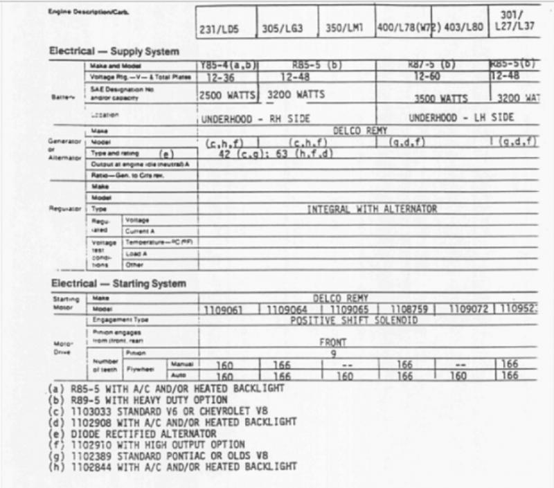

Thank you for pointing out there may be an error in what I've reported. I found the MVMA's for the 1979 Corvette and Firebird's and don't know what document I used to report what I did 7-8 years ago. I hope this helps...

Cool, it sure does. The alternator for the corvette certainly does NOT appear to be 1102908 based on your documentation, and low and behold, under the information for the Pontiac line, under equipped with A/C, the alternator number is 1102908. So, this does appear to be the correct alternator for a 1979 400 W72 engine.
