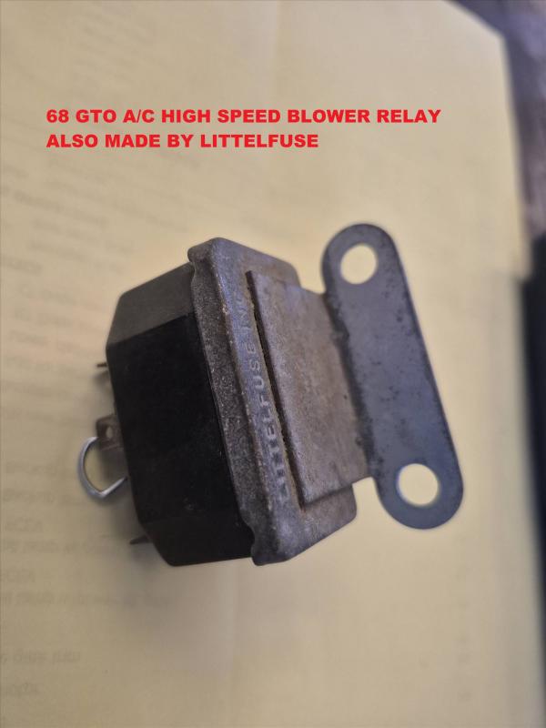

Yes, I also know that LITTELFUSE made the A/C high-speed blower relay, which is NOT what I am looking for.

This is a 68 A/C relay also made by LITTELFUSE, this is NOT the one I am looking for.
