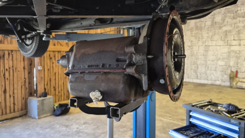

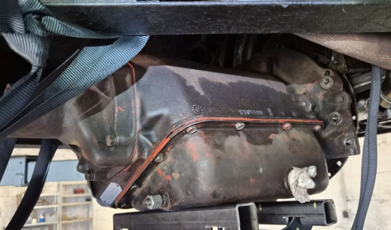

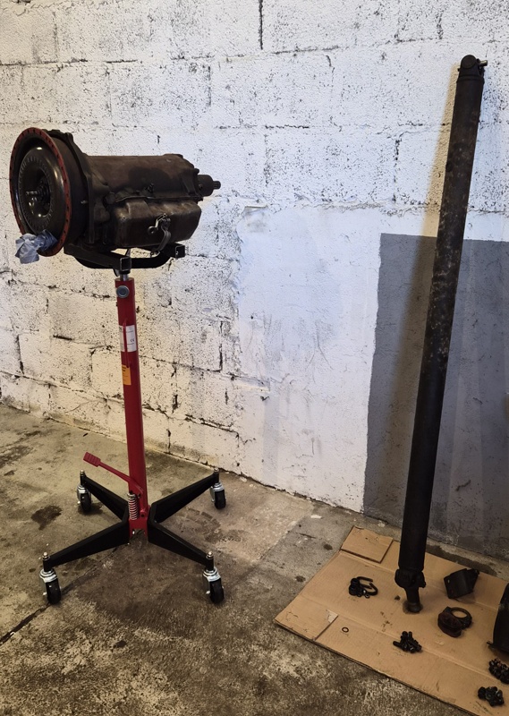

I carefully removed the transmission last week:
I brought it to the workshop already, which will do the rebuild. I hope they will contact me next week so I can take a look inside whats the problem. I'll do some pictures if I get the chance.

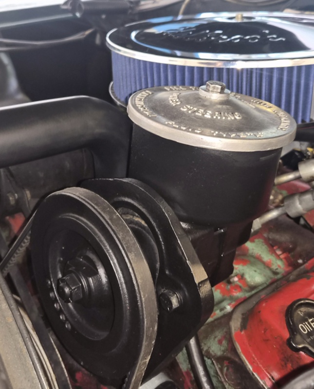

I took the power steering pump out, cleaned and painted it, and did a new (liquid) seal between the pump und the reservoir - another big leakage eliminated

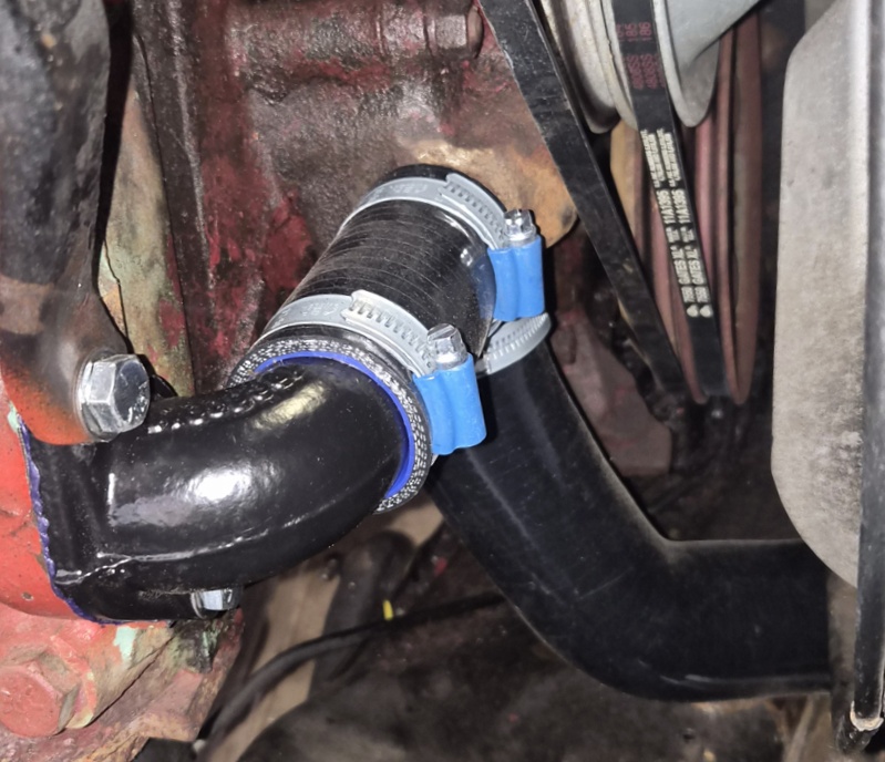

I also replaced all water hoses - including removing all the water flanges, sanding and painting them, new seals, new screws tec. I also took the thermostat out and literally coocked it, to check if it is still working as it should Forgot to take more pictures...:

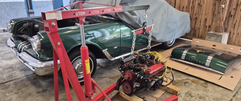

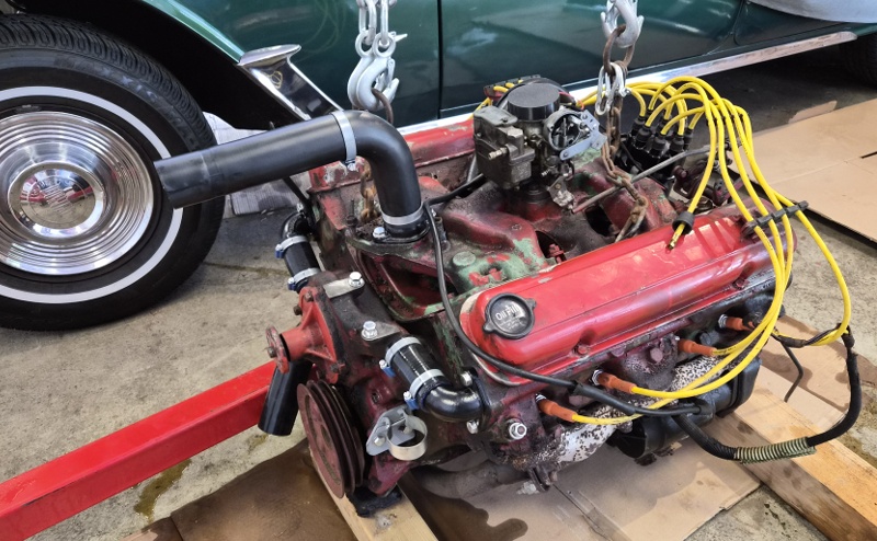

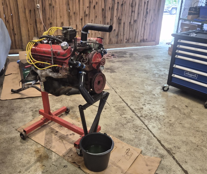

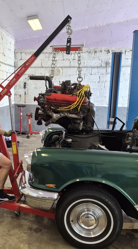

Next step happened: Engine -> out
Fairly easy since the transmissionw as already out:
First parts reconditioned already:

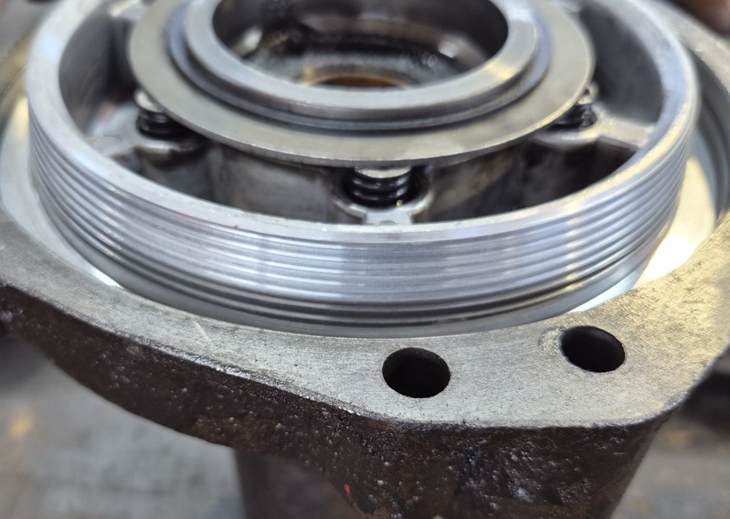

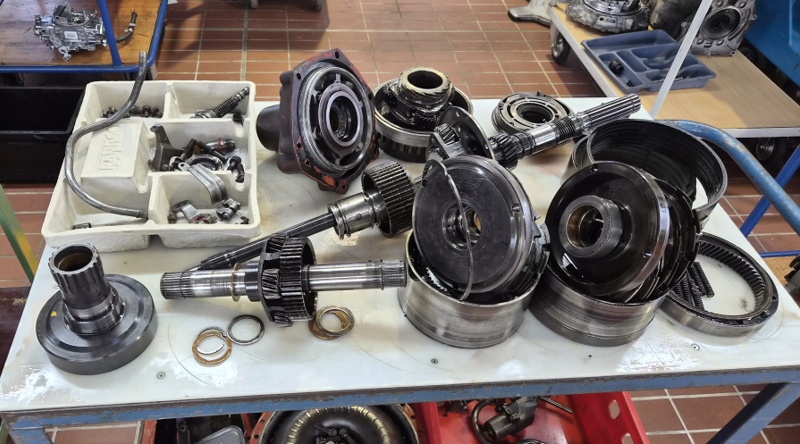

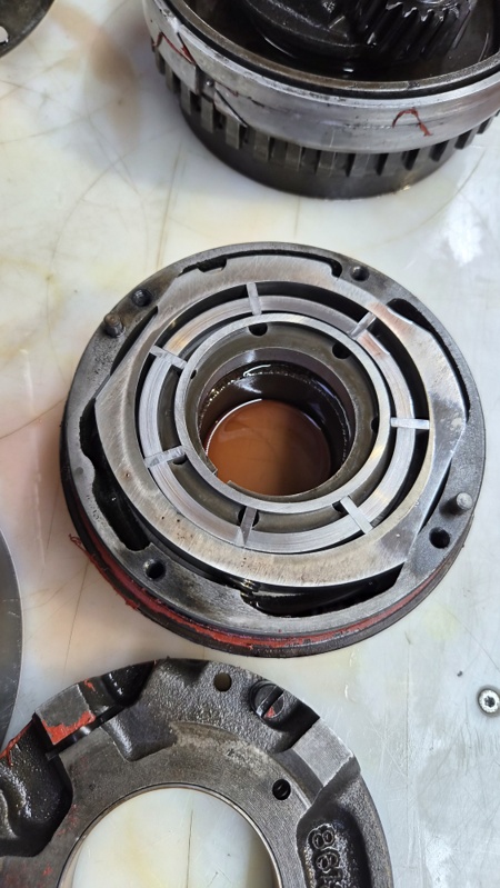

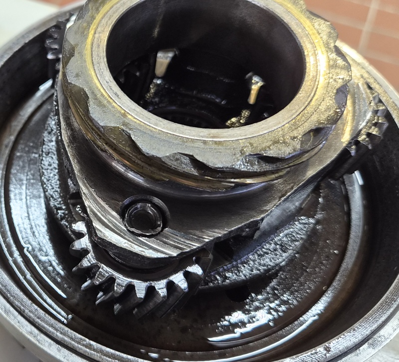

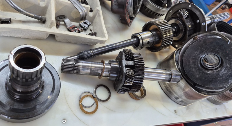

Last week I had the appointment with the workshop, to check out what the problem of my trans was.
The result was really frustrating, because a lot of the parts are damaged... See the pics:
These are all the parts of my trans we checked out together, a lot of marks from the brake bands:

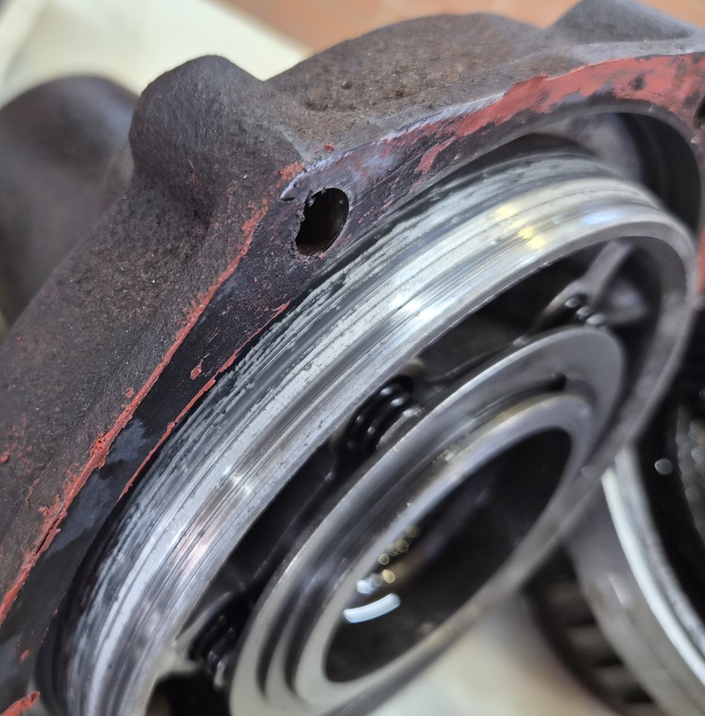

This is how the reverse cone looked, disastrous:
...this is how it should look:
This pump was at least ok:
Screws from neighbor parts have damaged and blocked one of the planetary gears:
All the clutches where completely black, burned out and most of them hat a wavy surface becaue of too much heat.
Also the brake bands were in no good condition, heavily worn and rather egg-shaped than round.
The good news is, that I got parts from another Hydramatic transmission (that`s where the other rev cone pic is from), from a '56 Chevy pickup (I guess). It is slightly different, shorter propeller shaft housing for example, but some of the defective parts can be used (the rev cone e.g.). The workshop owner told me that they can rebuild it with these parts, and renew all wear parts. It will take about 6-8 weeks they told me.
The bad news is the price, I will be even more expensive than I expected

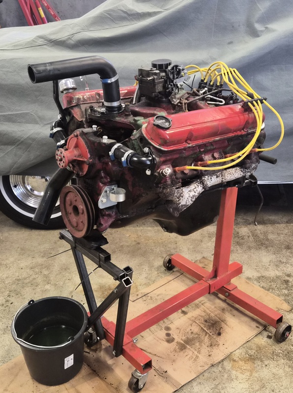

While the transmission is being rebuild, I will take care of the engine. Started building a stand:

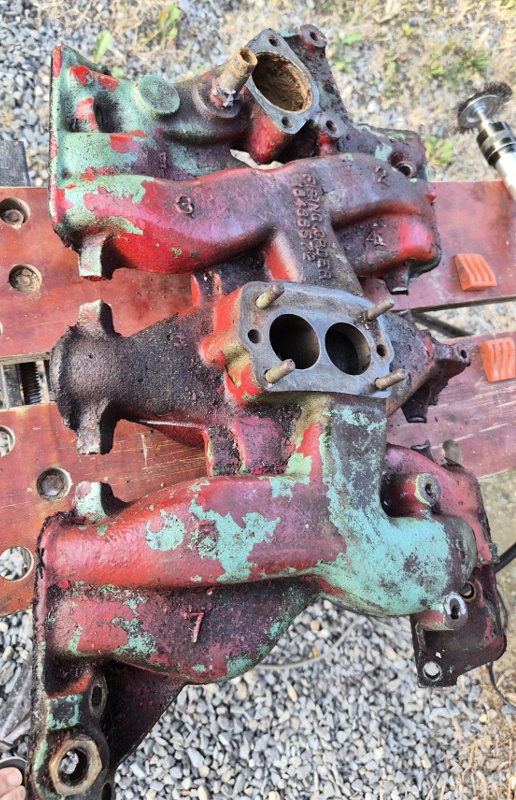

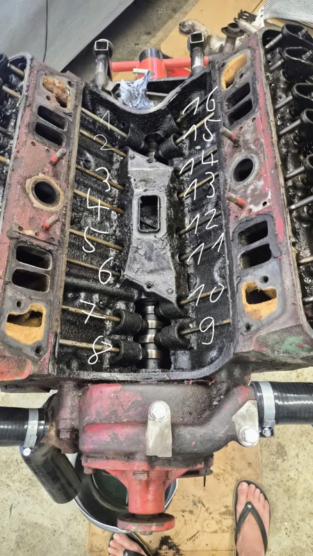

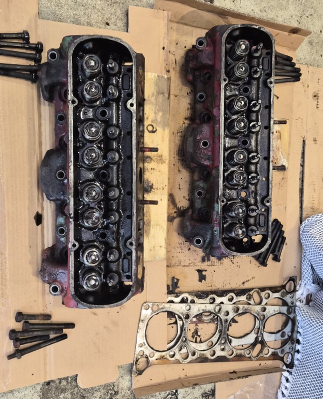

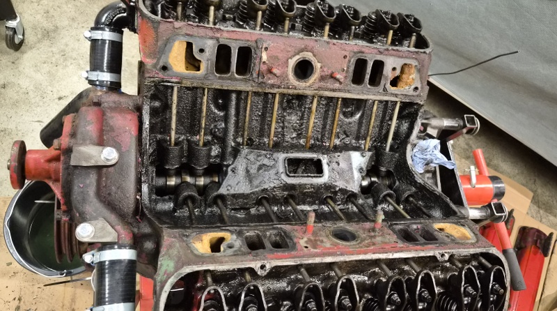

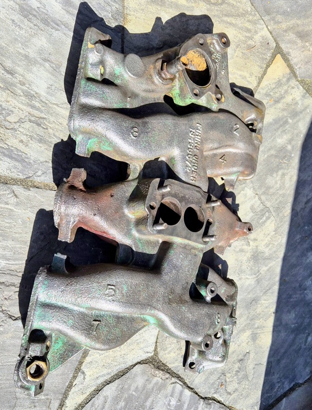

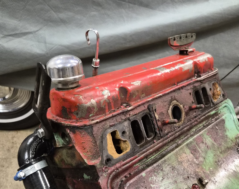

I started to dismantle the engine, really dirty inside:
Are these the original gaskets? Cylinderhead gaskets are fully metal, the intake manifold also has a metal part in the middle. Completely different from the new ones I got from Best Gastkets. Looks to me like this engine has never been opened so far... Or what does the experts say?

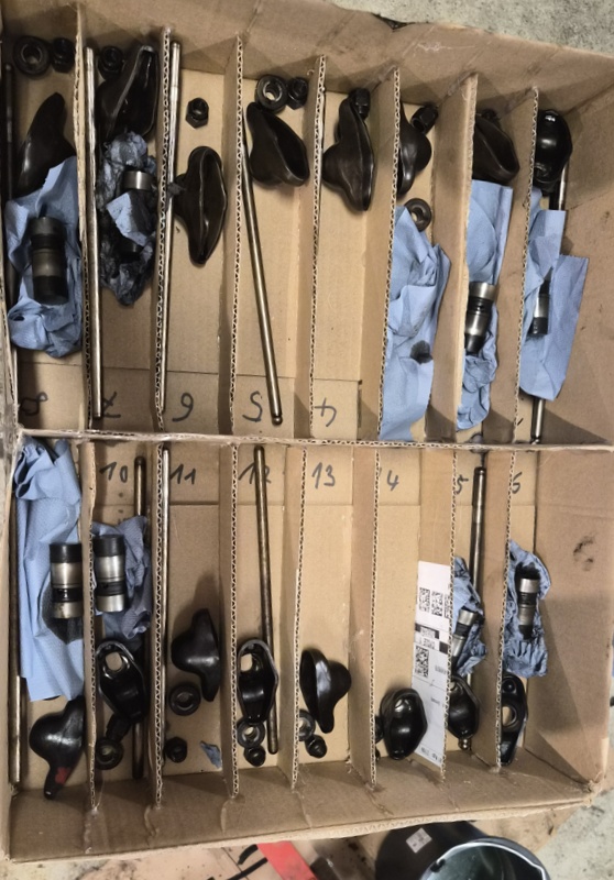

Valve train sort box (c) by Amazon package :
I discorvered that about half of the valvelifters have no more shock absorbing function, so I think i will replace them completely. Just saw they are available again on RockAuto

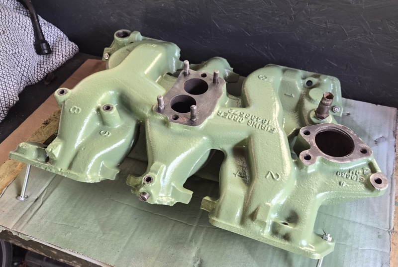

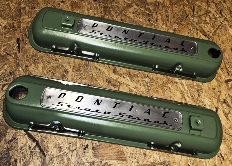

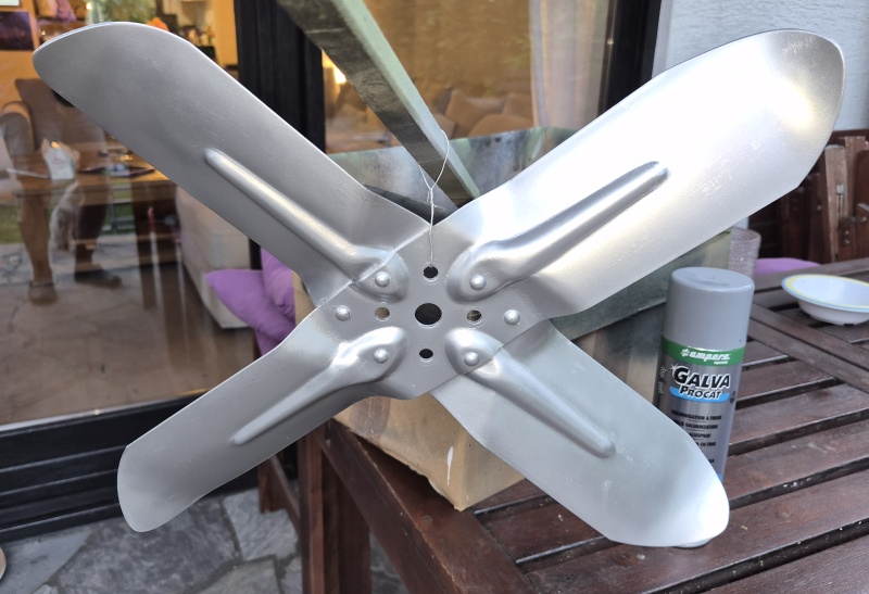

While all this work was really dirty, I had the need to do something beautiful too, so I cleaned, sanded and painted the intake manifold:
Today's two questions:
- I discovered that if I turn the crankshaft, the camshaft starts to move only after the camshaft has already turned approx 5 dgrees. This isn't normal I think, could be a worn out timing chain or loose timing gear, right? I Haven't opened the timing cover yet.

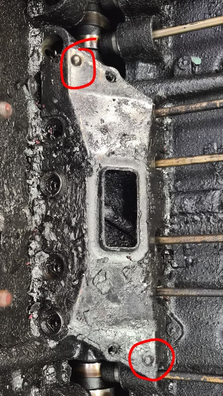

- How do I pull off these two bolts without destroying anything???:
I need to remove this middle cover to get the middle valvelifters out.

A lot of head gaskets have the part number stamped into them. Should be able to tell if the gaskets are GM or Fel Pro or something else. Those look like some type of a rivet holding the center cover in place. May be able to drill them out or use a cold chisel on the sides at the bottom to lift them a bit or make a dent or depression so that you can get a vise grips or something on them. Best would be to remove them without destroying them so they can possibly be reused, otherwise dont know where to get a replacement. It seems maybe I have seen a similar fastener on the bottom of a small block Chevy intake manifold. They have a tin shield in the center to keep oil off of the crossover if I remember right.

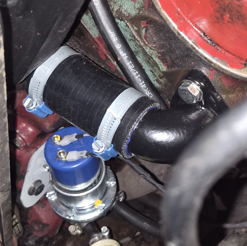

The fuel pump I switched to a "Hardy", see one of my older postings:
https://forums.maxperformanceinc.com...2&postcount=33
It's a really comfortable upgrade, starts so much easier after standing for a longer time.
