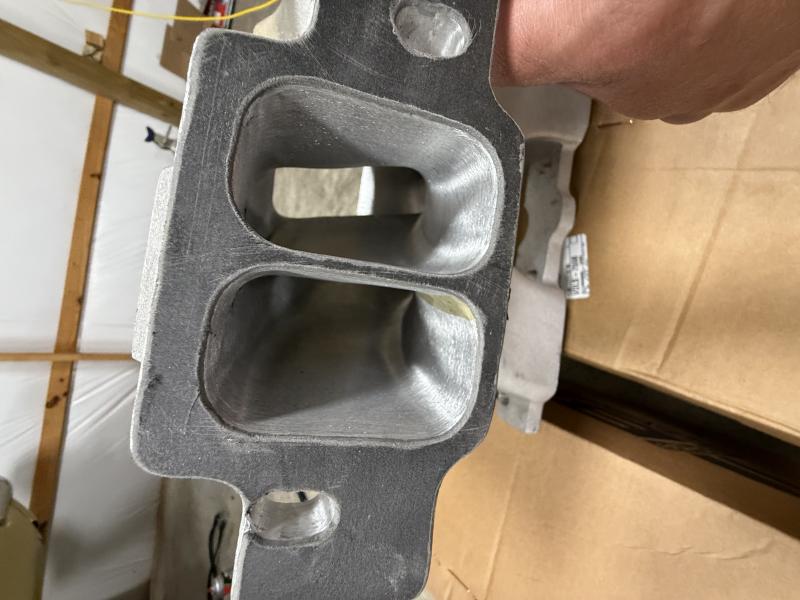

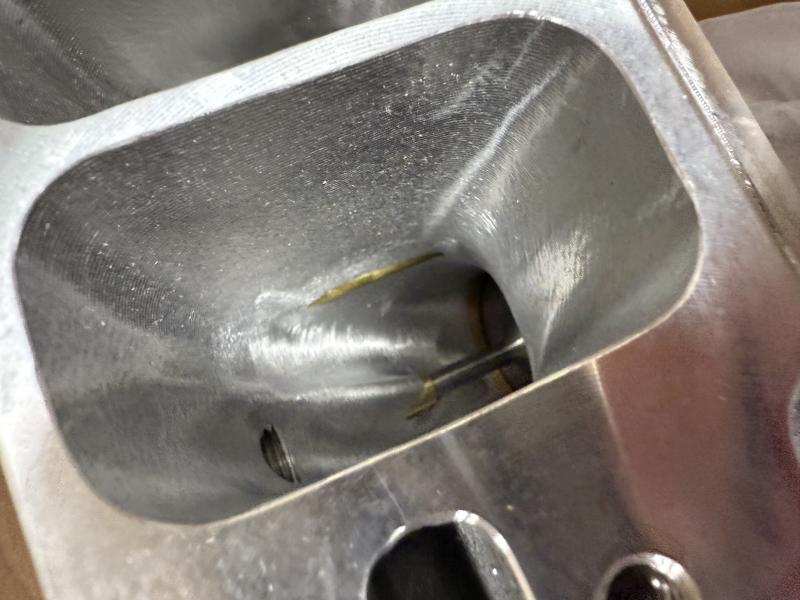

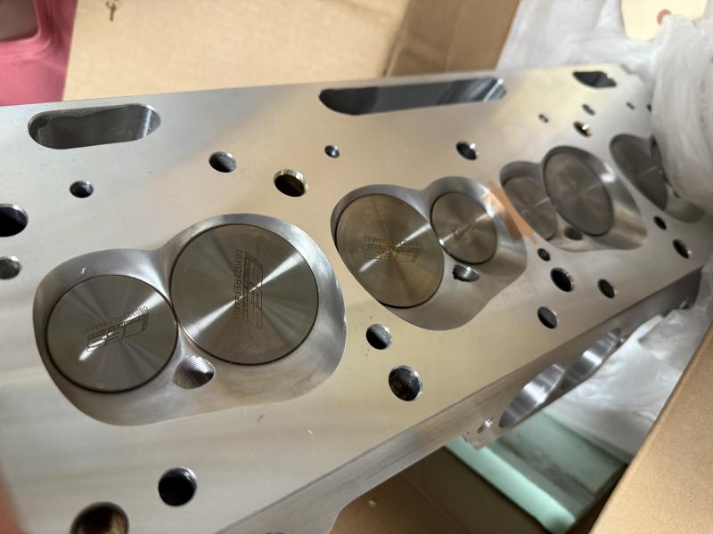

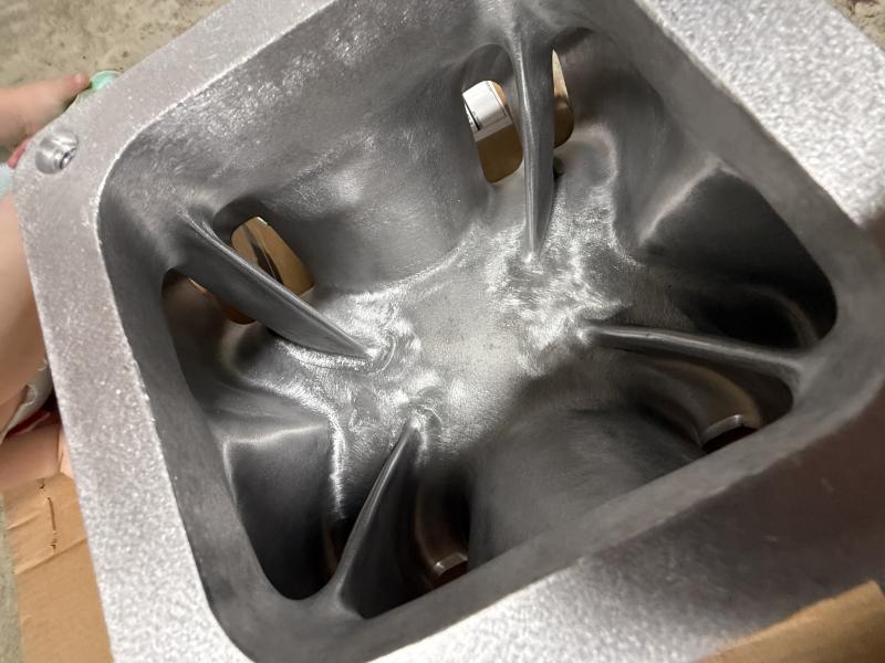

I received my big port pro ports and my worked BOP intake from BES. Their work looks killer, although my 2.5 year said the intake didn’t look good & needs work. After several phone calls & texts between BES & Scott Brown Scott sent me a pretty sweet little cam for this project . I still need pistons, rings & shaft rockers but am going to finish the season with my dci-5 build.

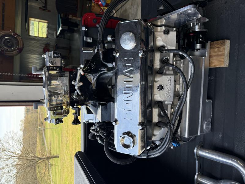

Default Finally

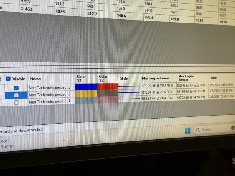

Got home this afternoon with project pro port. Engine builder only made 3 dyno pulls and I feel there’s more there but overall it should be a nice piece . It made 1078 hp @ 7200 & 858 ft lb trq @ 5600 with a 1250 get’m carb & a APD throttle stop. First pull timing was @ 35, second was 32 & final was 32.5. Not sure what gas they used but I think fuel factory F14. I also attached my ram air 5 dyno sheet.
Very nice! What cubic inches, and what compression ratio?
571 c.i. & 15.1
The ram air 5 set up was 15.5 & same cubic inch

I figured the average hp between 6500-7500 with this combo vs my dci5’s & dad’s dci 5 as well. Pretty happy with the numbers since the pro port had the highest average. Can’t wait to get it on the track. I’ve talked to my converter guy & he wants to start with the same converter I ran with my 5’s. Trying to make it an even playing field to see what real life track data shows.
