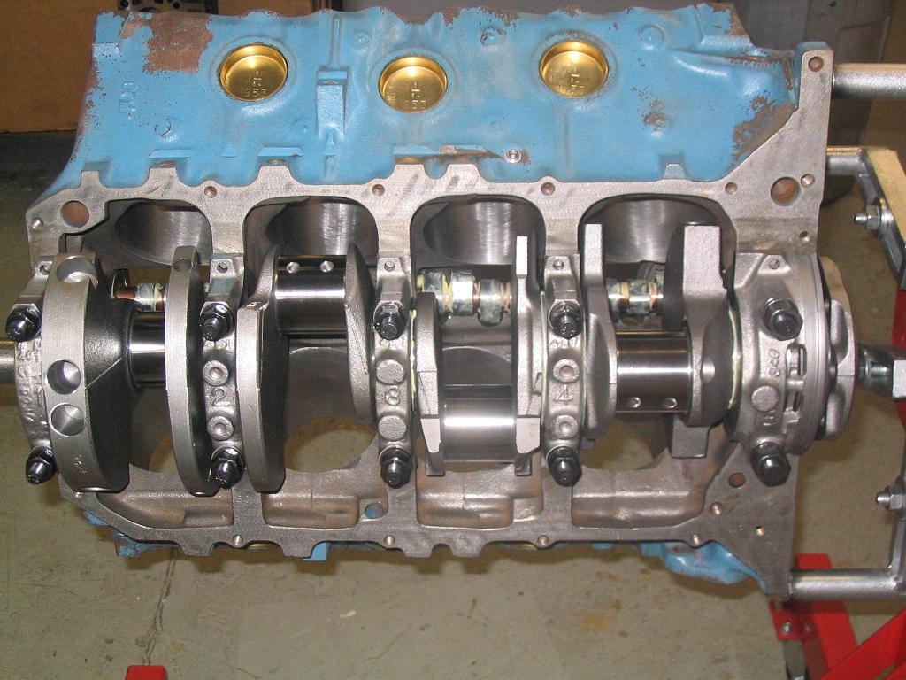

Location: Clifton,VA
Posts: 272
The Crank and Cam in the block. Nodluar Iron Indexed Crank..

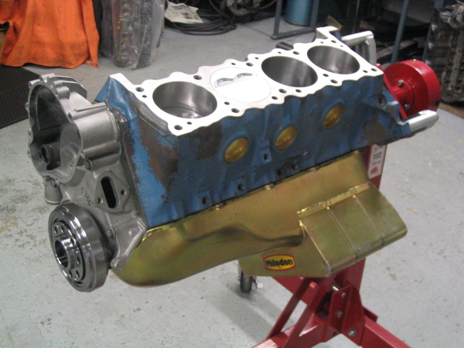

GTO71's Avatar
GTO71 GTO71 is offline
Posts: 272
THe slugs .005 in the hole, custom made JE Pistons 0.60 over.
Old 02-24-2005, 01:40 PM
GTO71's Avatar
Posts: 272
Side pic got that Milodon Oil pan off the parts for sale section in this forum.

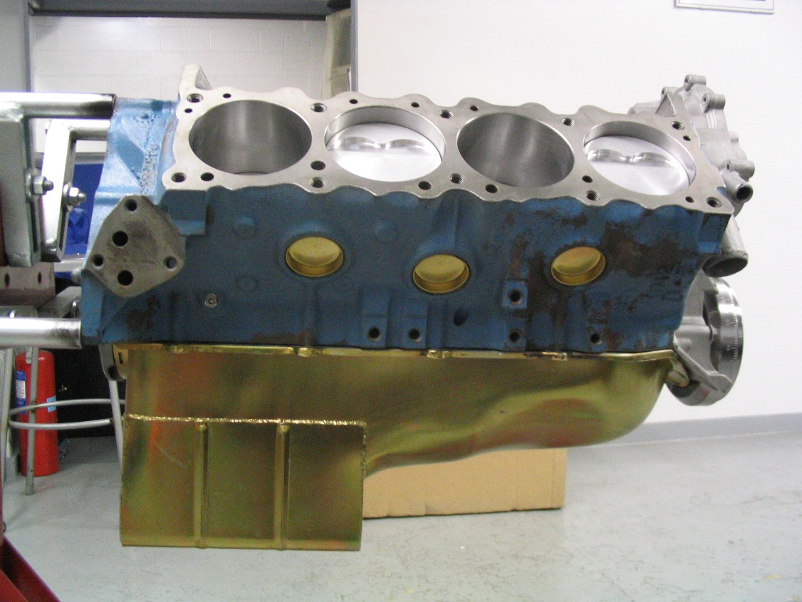

Posts: 272
Side Pic

Old 02-24-2005, 01:55 PM
Formula jg Formula jg is offline
Posts: 820
Which damper is that?

Old 02-25-2005, 01:50 AM
GTO71's Avatar
Posts: 272
Romac dampner, 9.5 to 1 Compression.

Jagtec1's Avatar
Jagtec1 Jagtec1 is offline
Location: Bryn Athyn, PA
Posts: 4,815
Am I missing something here?? A .060 over 400 with 102cc chambered heads will not give you anywhere close to 9.5:1 CR. You're more like 8:1 if the specs you gave are correct.

Old 02-25-2005, 11:44 PM
GTO71's Avatar
Posts: 272
Not missing anything, but you can't assume that I would give away me whole combo's specs!!!

Old 02-26-2005, 04:09 AM
Jagtec1's Avatar
Posts: 4,815
Blown? Turbo? Cuz, it's not 9.5:1!! Looks good, good luck with it. Just wondering why you said it would be 9.5:1 with those specs.

Old 02-26-2005, 07:21 AM
Mo's Avatar
Mo Mo is offline
Join Date: Nov 2003
Location: Philly burbs
Posts: 1,130
Maybe that crank has a little extra stroke in it.

Old 02-26-2005, 10:03 AM
Jagtec1's Avatar
Posts: 4,815
Could be, but it wouldn't be a 400 then! (See topic header) Just breakin stones! If it's a 4.21 stroke, that puts him right around 9:1.
