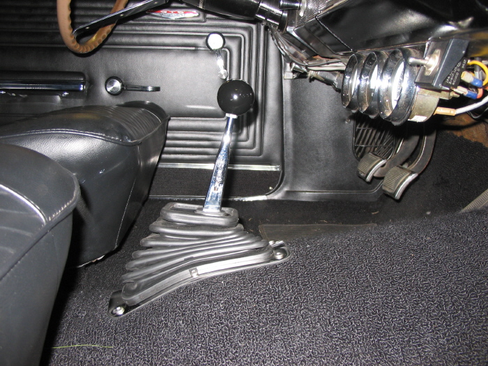

I'm going to have to buy another front carpet at some point because the new boot couldn't quite cover the old hole completely.

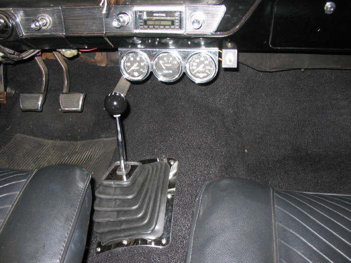

one more...

Hey, great job!
It looks like you are using a Lakewood bellhousing. How well was the center and parallel alignment? Did you have to use offset dowels?
I just indexed my Lakewood (I'm putting a tko 600 in my 69 firebird) and it was right on: 0.002" runout on center bore, and 0.0015" off parallel.

that looks real good maybe one day for myself

My bell housing alignment was about the same culick. Didn't have to change a thing! Good luck with your Tremec install. If there's any question I can help you with shoot me an email.

Thanks for those helpful pics Phil..you did a great job.

I REALLY want to do this swap...I just wish things looked a little more stock inside.

Actually mwritter, if you bolt a more like stock shifter arm in place of the shorty I used it will look more like stock. And like I said in one of the posts I can use my console with the offset shifter that I chose. With a console in place I doubt you could tell the difference. I just went the other route for now.
Thanks John! I'm real happy with how it came out. The tunneling doesn't look any different with the carpet in place. I basically raised it about an inch.
