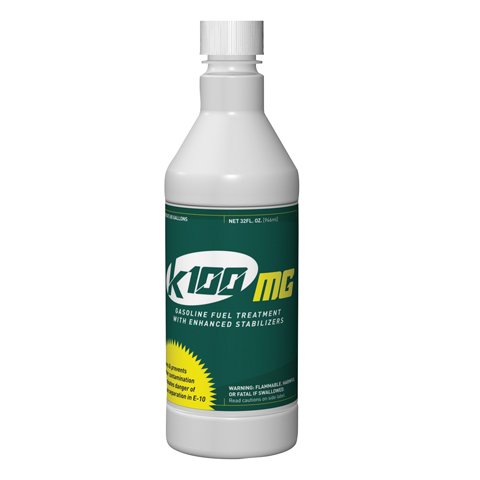

car on a storage lift in the summer heat all week...Phase separation...
Think on this.. the water is super corrosive, and rubber cannot handle that extra 5% alcohol. the combination isnt good. You'll need an additive that stops phase separation, just like the Diesel engines need a Lubricant for the newer low sulfur fuels to run efficiently
For Gasoline I use this after I saw a demonstration with water in glass jars at a Napa store, which sells many brands of fuel additive. It will burn the water to the bottom of the jar, and removes any separation. Sold me, the star tron, or stabil wouldnt do that.

Additives are a great suggestion. I'll have to start looking into that. I've traditionally been using Sea Foam as a stabilizer with good results, but I admittedly have not done a lot of research on the subject. More to come. . .

Most products that use the old "water and gas in a clear glass jar" demonstration are just alcohol based additives that combine with the water in the jar to produce a gas soluble solution ....in other words ...ethanol gas.
Look for your favorite products here:
http://www.fuel-testers.com/is_gas_a..._e10_list.html
To see what the ingredients are.
