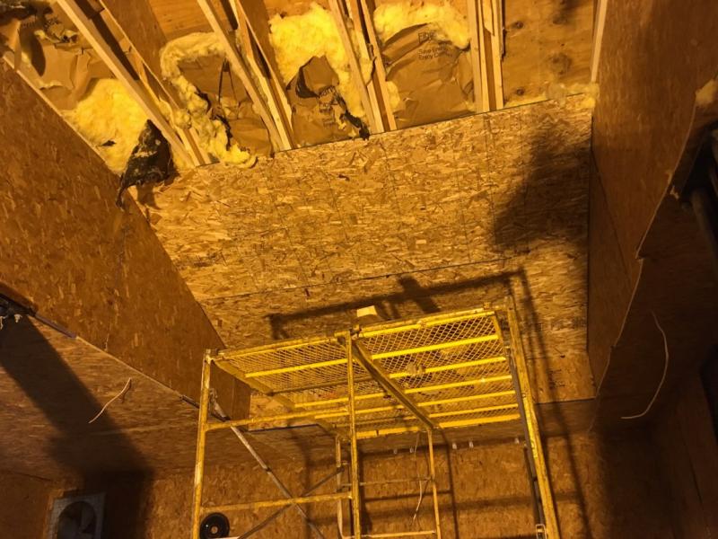

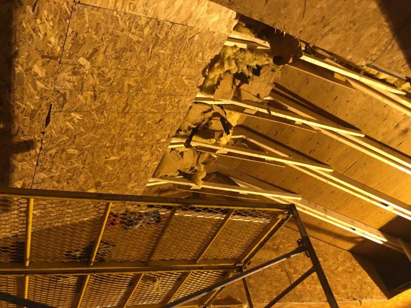

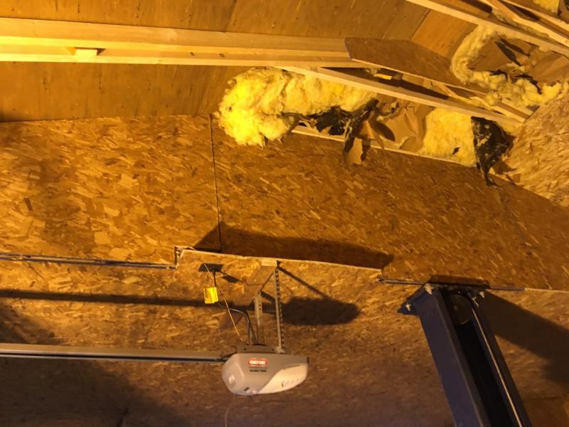

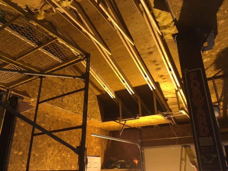

Recently helped a friend raise his ceiling from 10' to 14'. Cut out 4 trusses. This is what an engineer recommeClick image for larger version

ID:	475146nded. Not real expensive, but a lot of labor and time.

Originally Posted by rt400 View Post
Recently helped a friend raise his ceiling from 10' to 14'. Cut out 4 trusses. This is what an engineer recommeAttachment 475143
Attachment 475144
Attachment 475145
Attachment 475146nded. Not real expensive, but a lot of labor and time.
I was watching a video tonight about doing this same thing. My trusses run perpendicular to the doors so I would have to make sure exactly where I would place the lift.
