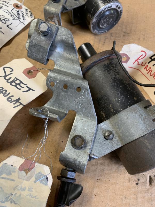

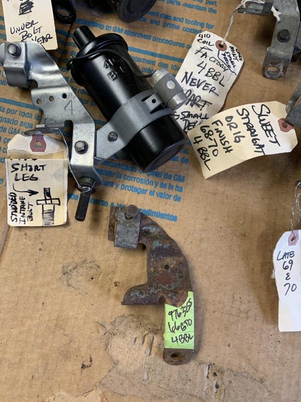

Sorry it’s a 66 bracket
Here’s what a stud type 4bbl should look like

Not sure if this helps, but because of this thread I checked my bracket ... it says "T 4" on it in big letters.
As does my original.

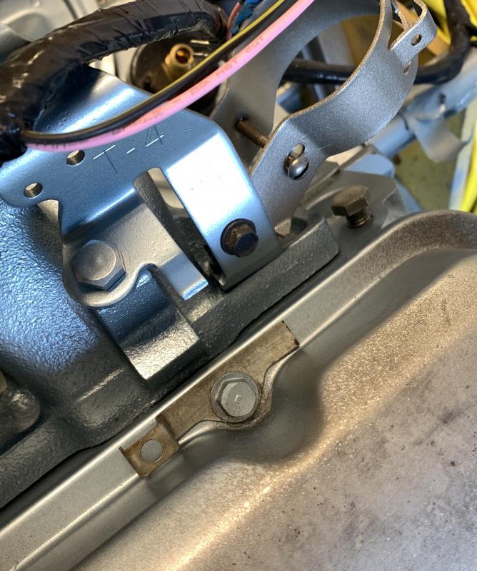

The '68 does not use the stud. If you look closely at Ed's first pic above, the lower leg is a bit longer so that it extends down to the manifold. The one I was trying to use is floating about a quarter inch above the bolt hole.
I had no idea there was so much to know about throttle cable brackets but I can understand why they changed it. With the '68 style if you want to remove the bracket you have to remove one of the manifold bolts. With the stud, it stays in place just like the alternator bracket that allows you to remove it without disturbing the t-stat housing bolt.
Old 09-15-2022, 05:24 PM
I'm eating so much crow nowadays, I swear I'm developing a taste for it.
I have a carport ornament level '66 GTO that I haven't started in years. I have a 389 and tri-power intake slated for....one of these days....and wayyyy back in the recesses of my mind it dawned on me that the present engine in the '66 is a '71 YS 4bbl.
You guessed it. It has a T 4 bracket with the long leg which is corrrect for my '68. As a BONUS....it was being held down with a '69 and later bolt/stud arrangement.
Problem solved. Thanks for all the help guys...It was educational for sure!

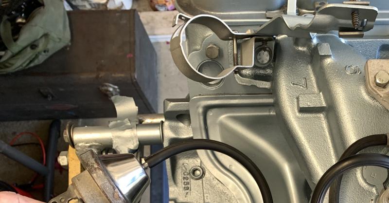

Everything is as it should be now...actually, for the first time since I've owned the car I'm able to set the idle properly with the idle screw on the throttle plate. I always blamed it on the various carbs I had in place. Finally took a good core and did a 'Cliff' build and thought that maybe the throttle shaft bushings were too tight....that's when I noticed that the throttle cable was as tight as a drum anytime I forced the idle lower using my thumb on the throttle shaft arm. As soon as I released the throttle cable tension by removing the clamp, the problem became clear.
Yeah, I think I need to break the camera out.

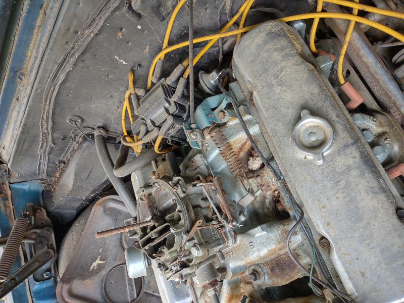

Great thread! I have a '68 that had a 350/2bbl and now has a 455/Q-jet on a Performer RPM.
My throttle cable happens to be too long; I'm not able to get full throttle by using the pedal.
Will post a few pics shortly, but it might be the carb throttle linkage arm. The carb was done by Cliff and I don't recall if it was a Pontiac version.
