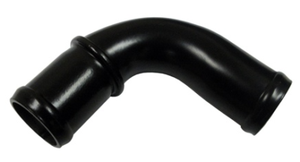

That's what the underside of my Z28 air cleaner looks like. If you have the center breather hole style valve covers like OEM, the tube points right at the filler hole. I bought a repro steel elbow and the short rubber connecting hose (also Chevy) and installed via a standard breather grommet in the valve cover. Looks like OEM and no interferences.
I don't see why you're having a problem. Just install the breather tube elbow at the 10:00 position on your aftermarket air cleaner and run a heater hose to the breather. It shouldn't interfere with anything.
On the factory air cleaner housing, install the tube at 12:00 (into the sidewall not underneath) pointing towards the breather and connect with heater hose. Just cap the factory tube off or cut it off and plug from below.

Sold on eBay:
Small Block Chevy Valve Cover Elbow For 1969-1972 Camaro, Nova, Chevelle https://www.ebay.com/itm/12567313671...Cclp%3A4429486
1968-72 Camaro Z28; Air Cleaner Breather Hose; with Open Element Air Cleaner https://www.ebay.com/itm/37501351138...86.c101224.m-1
Valve Cover Elbow + Hose Camaro Chevelle Nova Impala 68 69 70 71 72 Small Block https://www.ebay.com/itm/15382425664...Bk9SR5zns7LyYg
I lightened up the pic so you can see both elbows:
