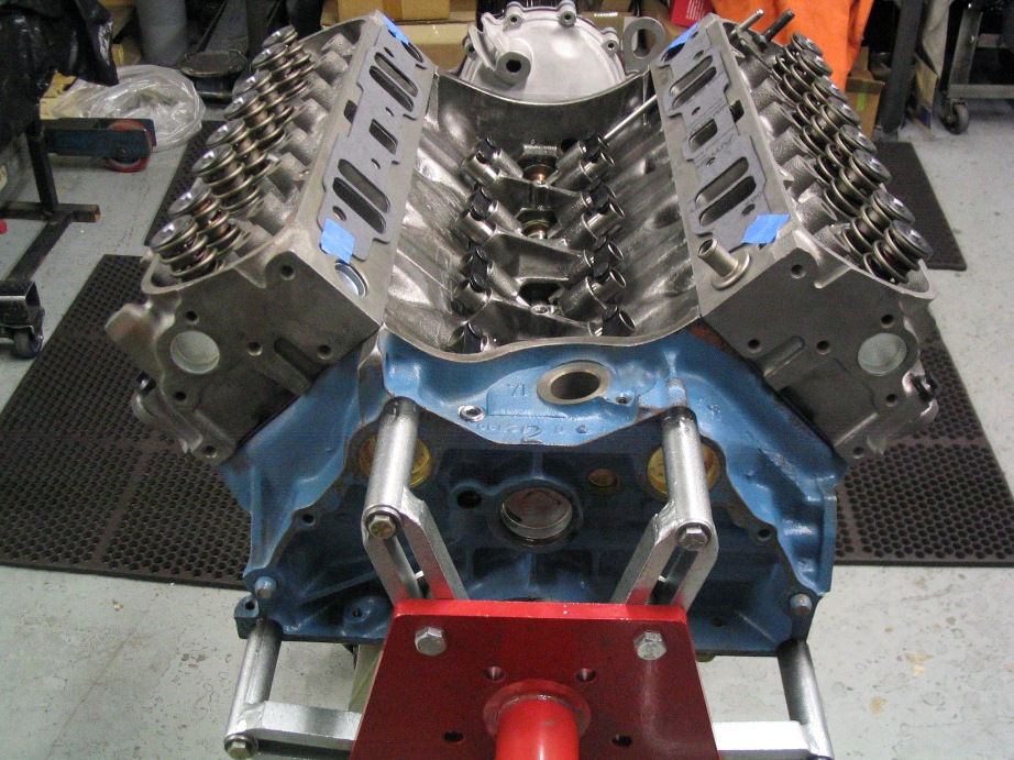

Finally got the heads on now

Side pic

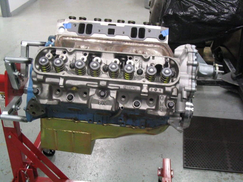

Rear Pic

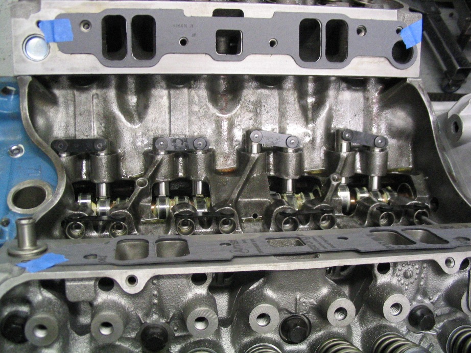

The Roller Lifters

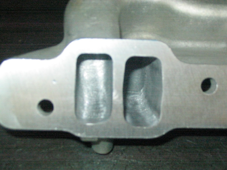

Intake manifold ported to heads & gasket
