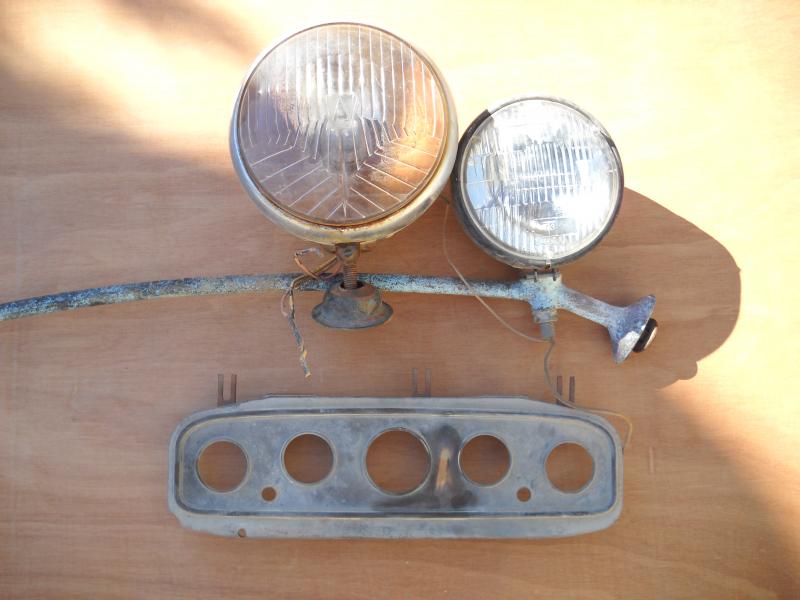

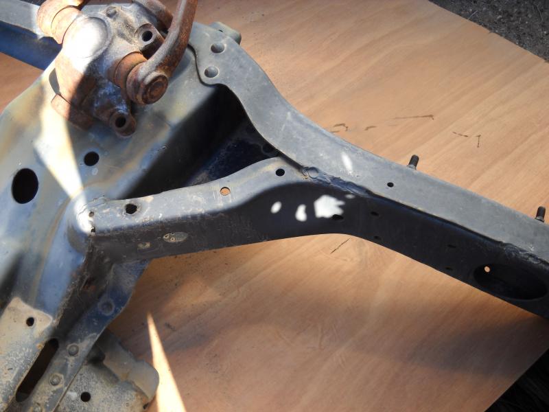

This is what I have to work with. Someone put T3 headlights on the light bar. I think the chrome headlights are original but I am not sure. The dash panal is made out of brass or copper. The rust is on the bottom of the cowl. That is the 34 frame.

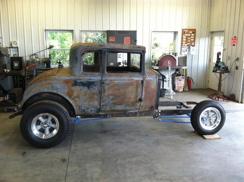

Ok in this pic you can see how the body is sitting on the frame it looks un hot rod. With the channel we drop the body down over the frame giving the car a cleaner look. Channels can be extreme in some cases more often seen in the rat rod crowd. I am only doing a mild channel about 2.5" I will be dialing that in on wedensday. I also decided to job the rear rails and go with a trunk mounted gas tank instead of using th original tank mounted behind the car (see earlier pics )

here is another pic you can see how much frame is exposed especially in the front at the cowl. My original plan was to only channel the front but with the change to the gas tank it was a no brainer to channel the whole body. The pontiac has a very nice curved rocker panel on a ford it is much straighter but ford guys have the option to put it on a 32 frame which is a sculpted frame and looks great.
