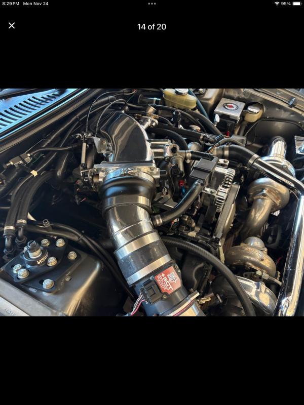

Originally Posted by charlie66 View Post
Zero issues, there holding up great. If I can figure out how to upload a video, I'll show you how fast they spool on the trans break at 5psi ...
How about you, any progress?
That's great news! I've been busy with home projects and coaching, but I plan on jumping back into the turbo stuff again in the new year. I tend to overthink things I have a new lower profile intake elbow on the way from Wilson's that will help with hood clearance. I want to run a factory steel hood instead of my fiberglass unit. With the way I want to package the system I think the GTX3584RS's will be my best bet. I want to retain my full 3" dual exhaust.
Wilson's elbow https://www.wilsonmanifolds.com/coll...acing-95-105mm
I've decided on the dual v-band 0.83AR units. They will make fabrication and fine tuning/tweaking the fitment easier. My plan is the package them similar to this with the downpipes running underneath/next to the crossmemeber tying in with my 3" exhaust
I'd really like to see the video if you could send it to me. Maybe via text or email?
