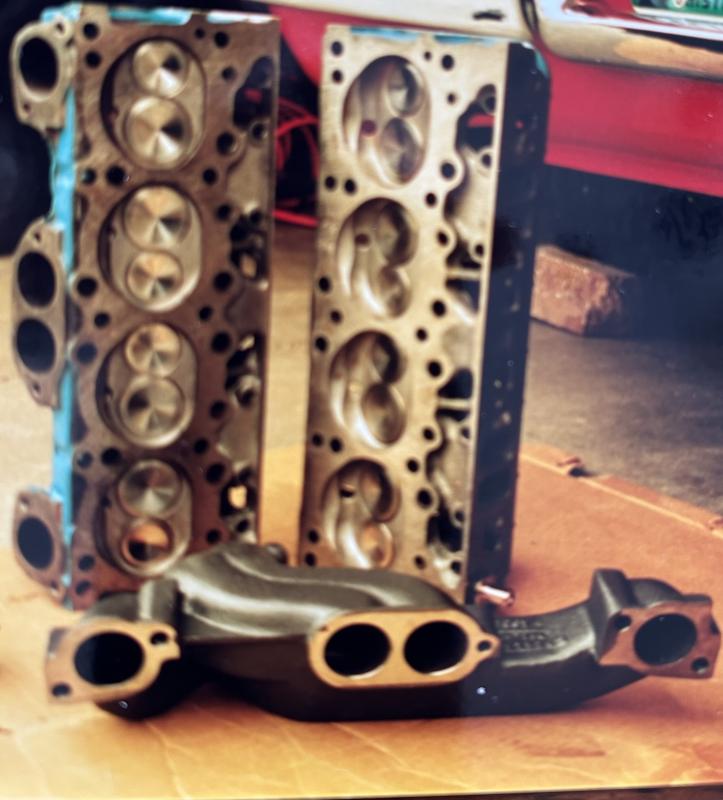

Here’s what I would call hogged out!

Too bad they were made / gasket matched that big at the exh flange .
There’s no need for that at all and it only makes for reversion and delaying the cam from coming into its power band.

Those particular Ram Air IV heads are not mine.Just a random picture of a Hogged out head!lol

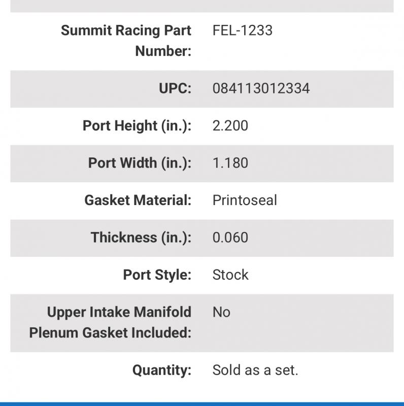

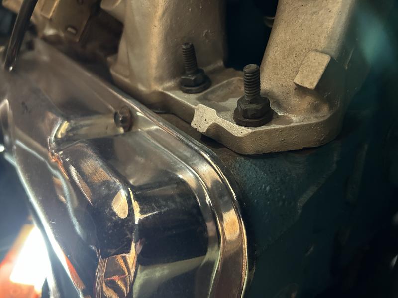

I mentioned that these heads may have been purchased out of Florida.I don’t remember for sure it’s been 24 years ago.I never stated that these heads for sure came out of Pontiacs back door only the comment that the individual made during the purchase.I stated maybe they did or maybe somebody just had them ported.The Felpro 1233 does work on the 455 SD or 455 H.O. and Ram Air IV.People on this forum have used them on the 455 SD intake side.

Understood..... The 1233 is smaller than a factory SD-455 port. It is the correct size for a RAIV/HO port.
You seemed to think Russ Gee may have been involved with your heads. I suggested, it seems more likely RUSS racing heads were involved with your heads. They even spell RUSS the same way it's stamped on your heads.

The 1233 works fine on the RAIV if all one wants to do is seal ports. If one likes to do chit wrong and trim gaskets it can be used on the SD455. The Fel-pro MS 90123 has the same dimensions as the factory RAIV gasket and it's a better choice. SCE offers the correct dimension gasket for the SD455, no need to trim or massage the bolt holes. But all the gaskets are missing the square forward corner the factory gaskets used.
You could look for RAV heads with RUSS stamped on them. I'd think he did more work with those and that might solve your mystery.
