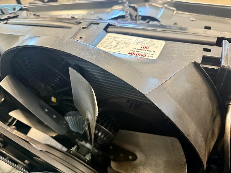

Originally Posted by Squidward View Post
...Car doesn't have so much trouble at speed, so I am going to try and 11" pusher fan in front of the condenser. Maybe an extra 1k cfm from a pusher at idle will be enough to keep it under control. I will run this to supplement a mechanical fan/shroud combo.
About 10 years ago I installed two 9" (I think) puller fans directly on the radiator in my '68 bird and wired them so they turn on with the compressor. The car would got hot with the A/C on in the summer at stop lights and in slow traffic, so I tried the electric fans as an experiment. It worked well, so I just kept everything in place. I have to replace the water pump gasket soon, and when I do, I plan on making some changes in the cooling system so that I can jettison the helper fans. Even though they work, it feels like a band aid solution.
Nice solution. Yeah, looking at a little helper fan.
So... What do you think about a pair of small pullers in the shroud, or a single 11-12" pusher? Pro/con opinions on either? I will be triggering a relay circuit off the FiTech.
