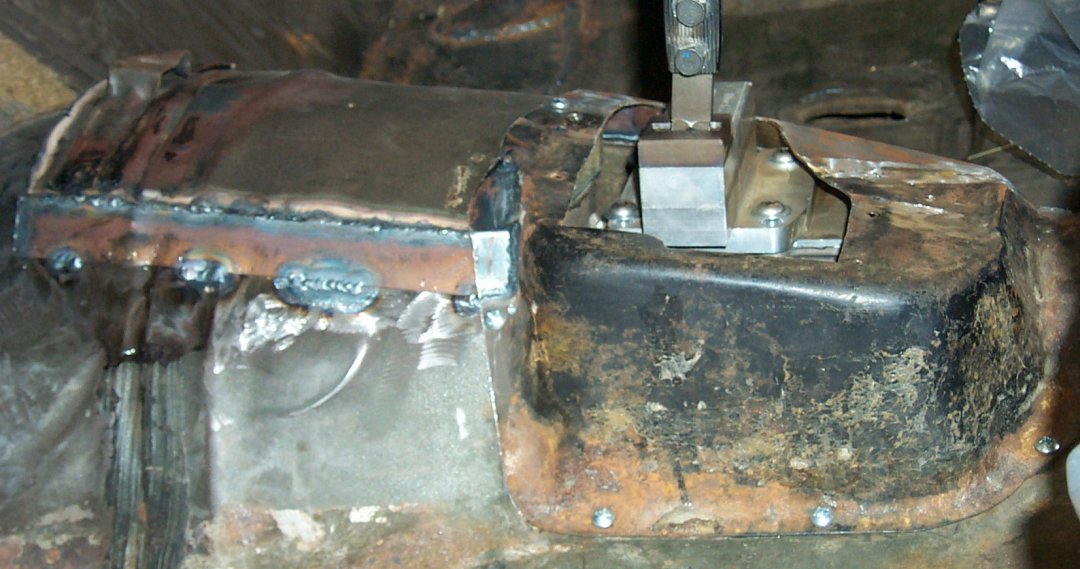

Silver Judge,
I don't think the floorpan mods are that crazy that your carpet won't hide them just fine. There was a guy on the boards that did a conversion with a 70 or 71. If I can find the pictures, I'll post them.
  #85
Old 07-26-2005, 06:04 AM
gearbanger's Avatar
gearbanger gearbanger is offline
Posts: 2,403
Silver Judge,
Tom McQueen was the guy, here are the pics.
  #86
gearbanger's Avatar
Posts: 2,403
Another, it's a 70 GTO

We now have a prefabricated tunnel patch with a cut out template and installation instructions. One of your fellow forum members is test fitting it into hos 64-67 GTO as we speak. It was designed by a guy with a 64-67 Chevelle and has been test fitted into the 64-67 Chevelles. We are assuming that it will work for the GTO's as well. We should have an answer within a few days.

The tunnel patch will work for the 64-67 GTO. One of the PY members (gearbanger - Alex Godsey) checked it out on his 64-67 and he said it would work just fine.
If you have any questions feel free to call me our get intouch with gearbanger for his thoughts.
The people who have done this install (with and without consoles) have given us positive feedback and have been very happy with the looks of the install after it was complete.
