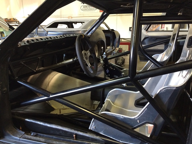

A few interior shots.
I'm not sure those seats will fit me. Can you have them upsize the drivers so I can make a trip around the neighborhood?
Looks great!

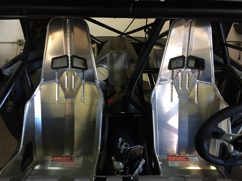

Looks great!
How wide of a seat do you suggest I use on the passenger side? Keep in mind the intercooler pipes still need to fit
A 20" wide should suffice. Hopefully we get to see it in Ohio!
mines got a 20" jeff you can ride with me ... someday lol
Sorry Jeff, the seats are Kirkey #41700, only 17" wide at the hip.

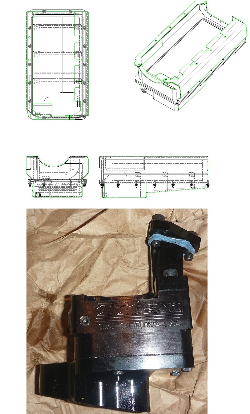

A few of the wet sump oil system mods for 2015 include a Titan Oil Pump and 2-Piece Moroso Oil Pan.
Lenny also cleaned up a few of the oil passages, enlarged the oil feed to the front main bearing and we'll be installing restrictors in the lifter bores.
