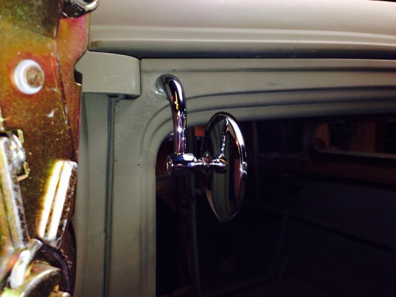

Nothing is easy if your not working on a ford example rear view mirror on a ford you just lamp it onto the door frame on the pontiac the frame does not have an edge to clamp to so an hour later after drilling through the door then countersinking a hole in the outer skin now I have a clean mounted mirror. It might need an extension and a larger head but I am very happy with it
