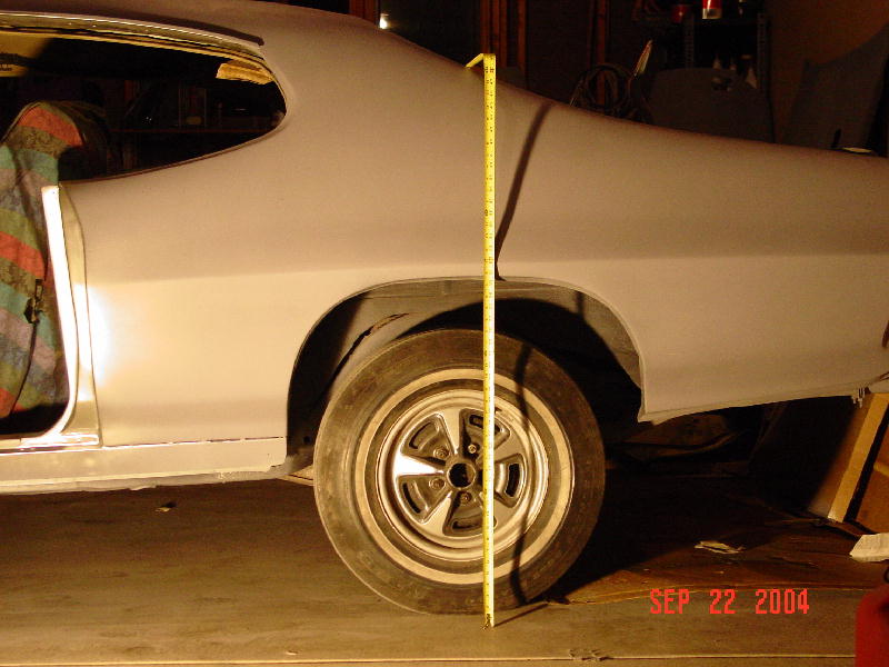

last pic, 30 1/2 inches from floor to lip,

That is exactly where mine sits. I don't have the gas tank in it though so it should come down a bit. I figure once my new front springs go in, it will be more balanced.
