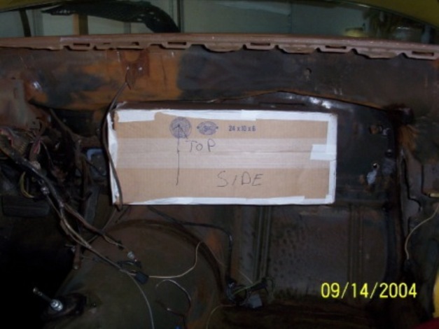

Ok, so I fabbed up a card-board box the size of the Gen II Compac (20.5" long x 9" high and 7.75" deep) I'm not very optimistic. Leaving room for the hoses on the passenger side, this is my best guess. Another thing for anyone that's done this. The 9" high clearance is the actual size, how much room do you need on top of that to route the ducts - I have none!
Opinions welcome!

I am getting ready to order a system myself for my 79 body. The only thing I can say in response to your mock up, is that the actual unit is not a rectangular box, so you have more room than you think. I did install a vintage air system in a 79 about 6 years ago. The thing did fit under the dash, and the ducts were very flexible.Unfortunately, I did not take any pictures. Glove box is a right off!

So it can be done!! Yea, I figured out yesterday that I'd loose the glove-box! I know I'm not going to get a real feel for it until I have the actual unit.

My current issue revolves around the fresh air cowl inlet. Since the Vintage Air doesn't use outside air, I'd like to seal it off. Now, if I seal it off, it looks like I could "modify" the interior to give me a little more top and back room. (It's the area just above where the arrow on the box is in my pic) Just not sure about starting to cutup sheet metal at this point though!
