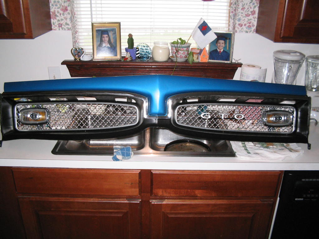

I agree with GTObully. Assemble the complete unit off the car and then install the complete unit onto the car. EJS67

You are aloud to work in the Kitchen
I keep getting kicked out to the driveway LOL
Just did this on a friends car this weekend
Much simpler to but the unit together on the ground and then into the car leave every thing loose then install
