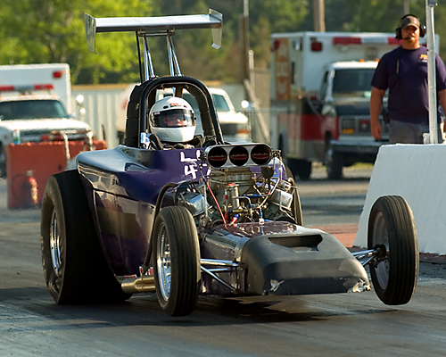

This is a shot of a run last wed. at Milan. 1.27 (1.24 was a typo!) 60', but shifter was'nt working, only went 9.29@142mph. Better luck this evening or fri.- 406", 13-1cr, OLD GK solid cam, 670 heads, P/Gw 8"5'000 stall converter-Bob.

Very cool, I will looking the next time I get to Milan. I am sure you will get her going faster in no time.
I have been racing altereds since '79 so if you like any help just send me a PM and I would really like to see it run.

How much does it weight, what tire size and what rear gear?

Is that a License Pass????

i think i remember him saying in another threat that it weighs ~1800~ pounds.

Bob,
Did you wind up "stuffing the intake runner" that we talked about or running it as cast?
Great job by the way!

Thank's for all the replys!-Went to the track today (milan) Hot as he!!, bad air, only got 3 passes, but wound up going 9.14@144mph after I leaned it to a .115"pill. I have heard it may take up to 3 week's to get my lic. back from IHRA, so I am still doing "licence" passes till then. Am running 16"x34"x15" "stiffwall" tires with a 4.30 gearset. And yeah Tom V., I am running the gutsram with the 3/4"x 6"long wedges in the roof we talked about. Have to do a 1 to 1-1/2 week welding job in Dayton OH, so wont be posting for awhile! Hopefully have my lic. when I get back!- And Tom, me, you and Rich Cole have to do lunch sometime before Norwalk, if at all possible!-See Y'all later!!-Bob.
