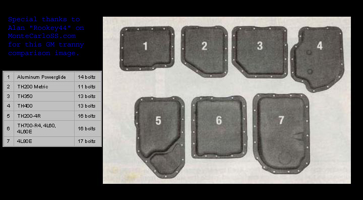

Old 02-20-2005, 11:23 AM
79GP6.6L 79GP6.6L is offline
Posts: 43
Just crawl under the car and check out the pan.
