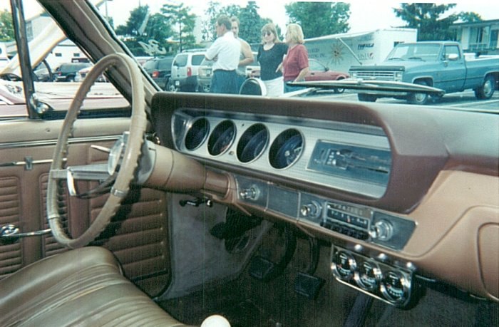

I have the same color interior. I still don't understand which color code from the attached chart that is for a blue interior. There are 2 blues for 60 degree gloss but only one for 0 degree gloss. By the way, where is the break between the 60 degree gloss and 0 degree gloss on the dash

the breaks between the low gloss and high gloss are where the brown and cream meet.dont know how to make the paint lil64gto recommended flatter for the top of the dash,as its laquer,but i'll let you know if i figure it out.

The duller goes on top of the dash for glare reasons,
the 60% goes on the lower portion and above the door panels on the doors and rear
yes there is a little metallic in it for the blue.
The two diff gloss is how I believe it is correct for a two tone.
otherwise on mine I believe it is all 60% met blue when one color on the dash is used. You can gloss it up but would not look right for "factory" plus it keeps the glare down from the sun.
