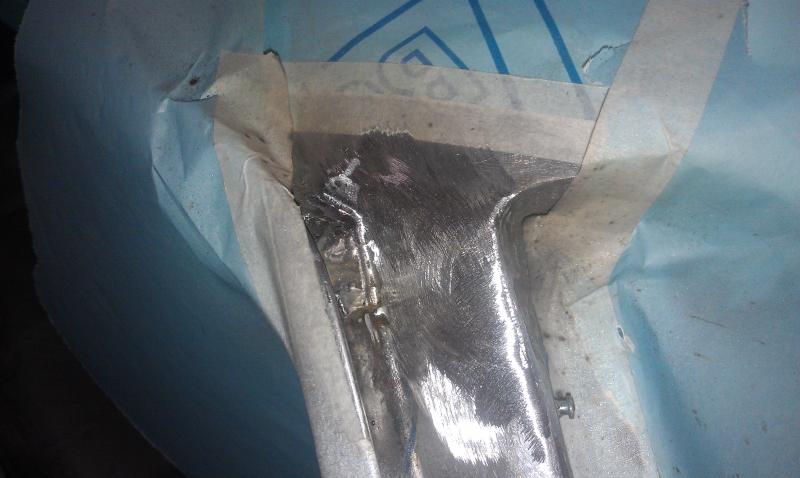

Finished repair on the roof seam. Removed lead with torch, prep area with metal ready and re-weld seam, coat seam then weld in patch. Ready for body work to finish. Use fiberglass or all metal?
Thanks for the advise guys.

On my quarter sail panels I did what you are doing. For filler I 1st put down a layer of fiberstrand bodyfiller and shaped it, them skim coated it with all metal. irgoatmike

I'm not sure if putting all -metal skim coated over the fiberglass is a good idea? Why would you do that? My thought was skim coat of the fiberglass filler then finish with skim coat of bondo or glaze or use all metal instead of fiberglass? I have no experience with using the all metal or my bodyman? Do I need to do that at all after welding seam?

I would not use fiberglass filler after welding the seam and plating it. I don't use the all-metal filler on anything, it's not all metal at all. I don't get it. We simply skim the area with a good quality, pin hole free filler. then primer.
I'm not saying the other way wouldn't work. it's just not how I would do it...

Use body filler. The repair shape looks real good so you only need a minimal amount of build.
