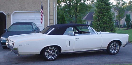

I put a set of Moog Cargo Coils I got off a junk '67 Lemans HT on a '67 Lemans convertible and the ride height was exactly stock and it was very firm.

android 211 how do you like the springs? Can you post a few pics of your car at different angles?

http://ultimategto.com/1967/67_00153_1.jpg
Its not mine; it was a car I helped a friend with. I robbed my stash to get it on the road. He painted it at home. (ex bodyman). 45,000 mile Kansas car sat from 1979 to 2004. I know what kind of springs they are because the tag was still on them. The fronts were "Moog Heavy Duty"
