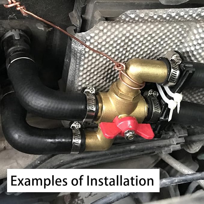

i meant something like this:
https://www.amazon.com/Joywayus-Auto...Y2hfYXRm&psc=1
Old 07-07-2024, 11:09 AM
Posts: 5,386
a fine example of installation from the ad...
