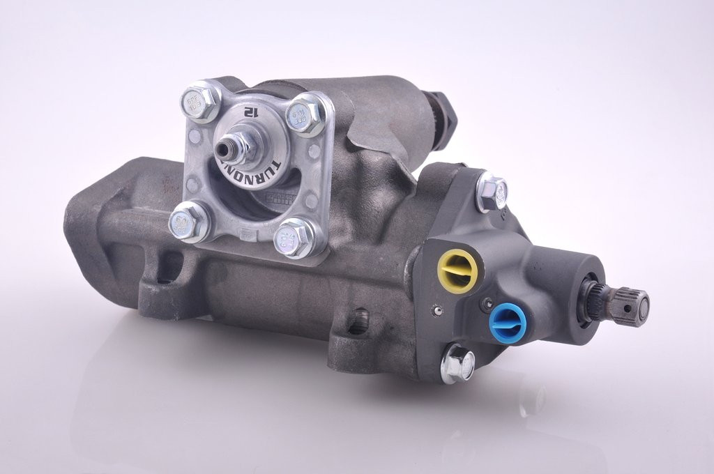

This is the best steering box you can buy:
https://turnonesteering.com/product/...ering-box-sb1/
You may get lucky with a GC box for less but these are new and there are none better for steering feel and quality.

You will pay a LOT for the box shown in post #2....& it won't do anything better than a rebuilt 2 1/2 to 3 turns lock to lock box.
I have run them in two vehicles; a 2nd gen F and a 71 A.
1. The F was a 79 Trans Am with a box of unknown condition - it was replaced by the then Delphi box from Ames. Compared to a WS6 box a friend had in his 79 it was night and day - especially on center feel.
2. The 71 had a reworked IROC box with stop corrections that I drove for 20 years. It was replaced by a Turn One version of the discontinued Delphi - once again significantly better.
Tell us about your personal experience here with the Delphi box. Not what you have read on the net or other heresay, actual experience.
$999. But it doesn't end there. The later
PS pumps put out more PSI than the 67.
And this has a 30 spline rag joint. Comes
with AN6 fittings. I won't lie, it sounds like
a real nice PS box, but I don't think this is
what OP was looking to do...
I wouldn't say a 12:7 box is "stiff", it's more
like they've broken away from the hyper
assist. Some folks like the "wonder touch"
steering where you can flick the steering
wheel with just one finger.
If you see 80s musclecars, or a Jeep GC, at
a used car lot, take a test drive?
