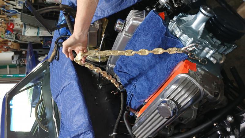

Probably a dumb question, but can i use that hole attatched to the block on the d/s to lift the motor out, thinking i could use that and the hook up front on the pass side and have the chain from one end to the other, never did it this way, wanted to check with you guys if anyone has done it this way, also would i need the chain alot tighter from the way i have it now on the pic.
I do have a leveler/tilt deal, just hate hooking stuff to the aluminum heads.......and tips would be appreciated

That should be OK, especially with aluminum heads.

I have done it that way before. Coming out it doesn't have to be too level to just get it out. Putting it back in would be more difficult to align everything.
The hook thingy on the front though will probably bend when used. The factory had a metal bar thingy that worked good.
A piece of steel long enough to bridge the chain to keep the angle on the front loop from bending could be fashioned probably.
But I usually used the head bolt holes to pull the engine with no problems.
(could use some metal shim to protect the head surface from the bolt/chain rubbing it)

Will it work, sure.
The lifting points are more than adequate.
Unfortunately you have no control that way, if the chain slips in the hook or if it wants to go wonky you may end up banging into things.
Just attach the leveler to the heads, it’s not like the threads in the aluminum aren’t strong enough.
I would bolt the intake back on and use a carb lifting pad long before I’d run a chain like you have pictured to do the engine removal.

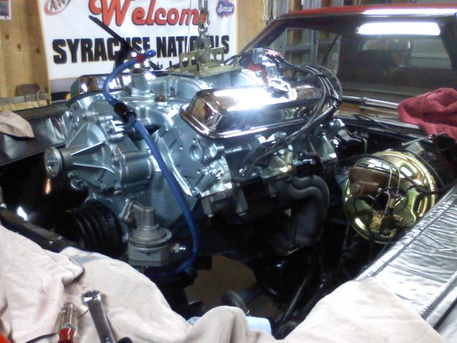

I retired my leveler ever since I bought my Mac’s Pivot Plate. As pictured below attached to the center carb flange on the ‘64 Tri-Power intake, small-base Rochester at that. I’ll never do it any other way.
Those four 5/16” carb studs are plenty strong, even with an aluminum intake.

So here we go. Last time I pulled my 3X2 engine I used the chain just like you are. I left the carbs on and put a BF screw driver thru the chain against the cook to keep it from sliding. I'm alone. Works good. Installed the same way. Everyone does it differently. If you feel confident, go for it. 78 and still wrenching!!!!!!!!!

Thanks guys, i will use the old leveler, b-man i was thinking about gettting one of those years back, just worried the center carb flange studs with the alum manifold..........thought too risky, but it seems you pulled it off, trans included lol...........i only have the motor, the tkx i already pulled out.

FWIW, the 5/16-18, grade 2, studs/bolts are rated for a tensile strength of 2900 lbs. each. 4 will hold 11,600 lbs. they'll easily support a Stratostreak V8 at around 700 lbs. and 850 lbs. with a T 400 hanging on the backside. The worrywarts can relax............

Hey thanks guys, got that puppy out today, went fairly easy, other than more anti-freeze leaking was not too bad of a job.......still thinking of getting one of those tilt deals like b-man has, just cant get it out of my head hanging the whole motor with the center carb on a tri power manifold. sometimes those studs feel loose just taking off the air cleaners. lol.
