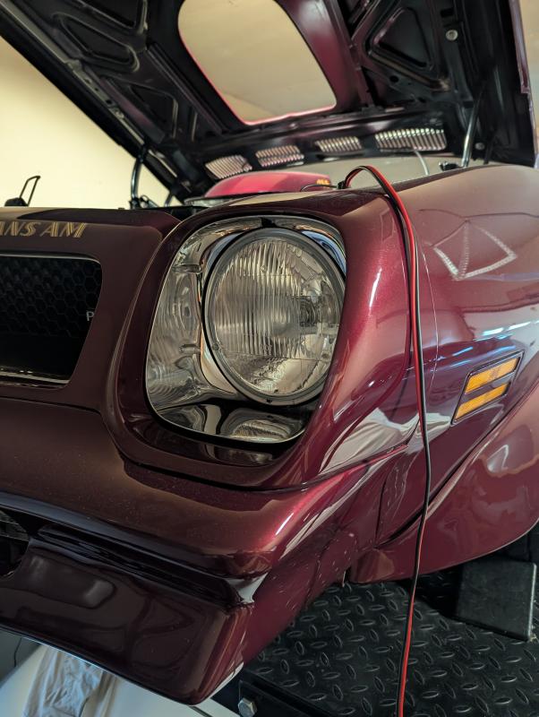

I added these to my 76 TA a few years back. Happy with the results and improvement.

I just got the rampage set up ,much brighter and didn't break the bank at 140
