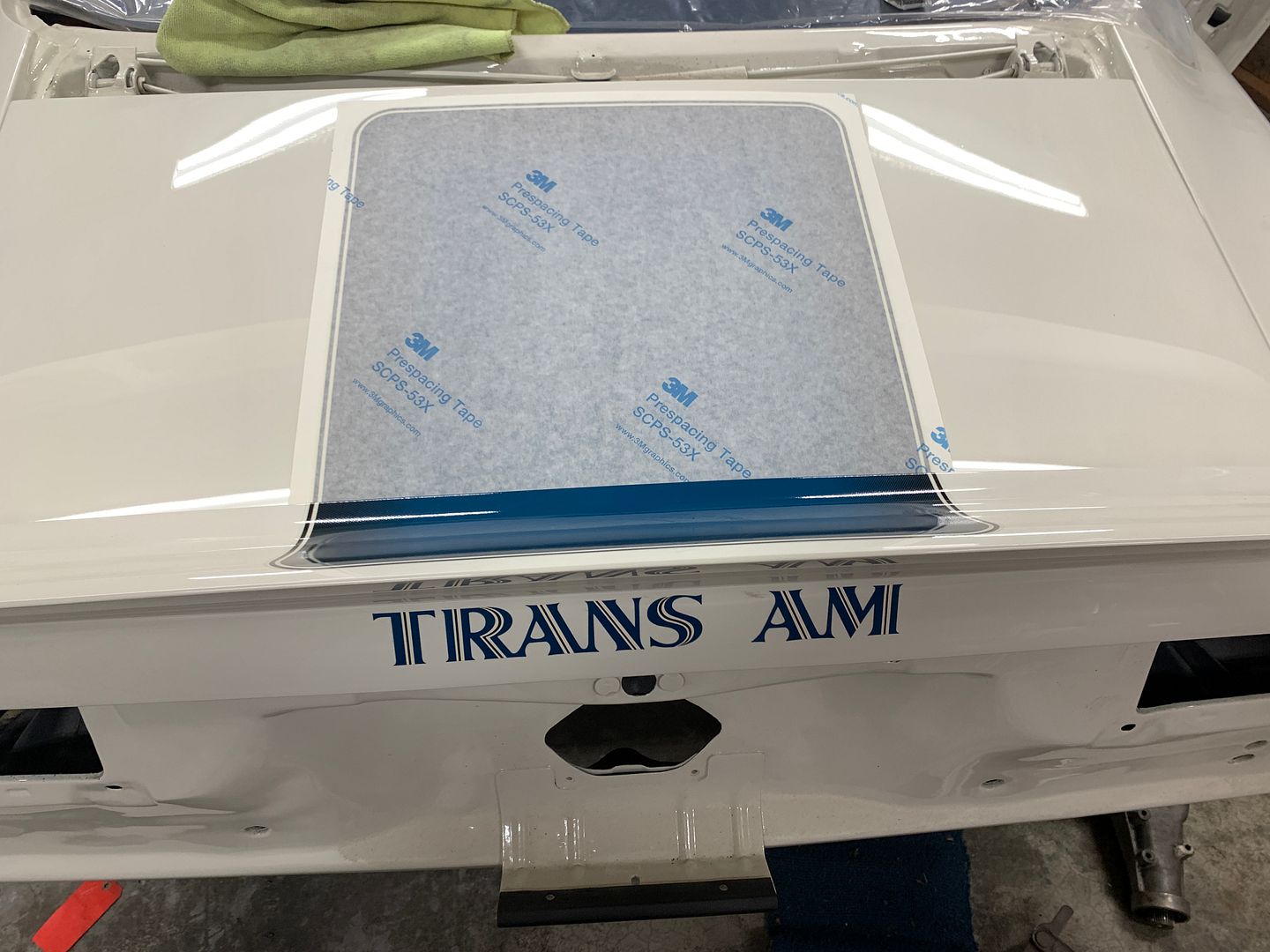

The Stencils and Stripes kit comes with the old Pontiac drawings with key measurements from various other features.
For the trunk lid I first install the spoiler stripe centered on the spoiler left to right and wrapped under the front edge of the spoiler the specified .30 inches in the middle. I use a laser to give me a center reference and plenty of masking tape with pencil marks for when I peel the backing, apply my gel and start to place the decal.
Then I place the spoiler on the trunk lid without fastening it down and place the trunk lid decal without removing the backing yet so that it is centered on the trunk lid left to right and the lines on the trunk lid decal line up with the spoiler decal and slid .30 inches under the spoiler in the middle. I use plenty of tape and marks on the tape so I can line things up without guessing once I've peeled the backing off.

S&S will send you this sheet with dimensions. My interpretation is 1" down from the top of the spoiler, and 1" down from the forward edge of the trunk lid to the stripe. This will match the roof stripe 1" dimension.
TA455HO tree'd me! He has excellent instructions to help with installation.

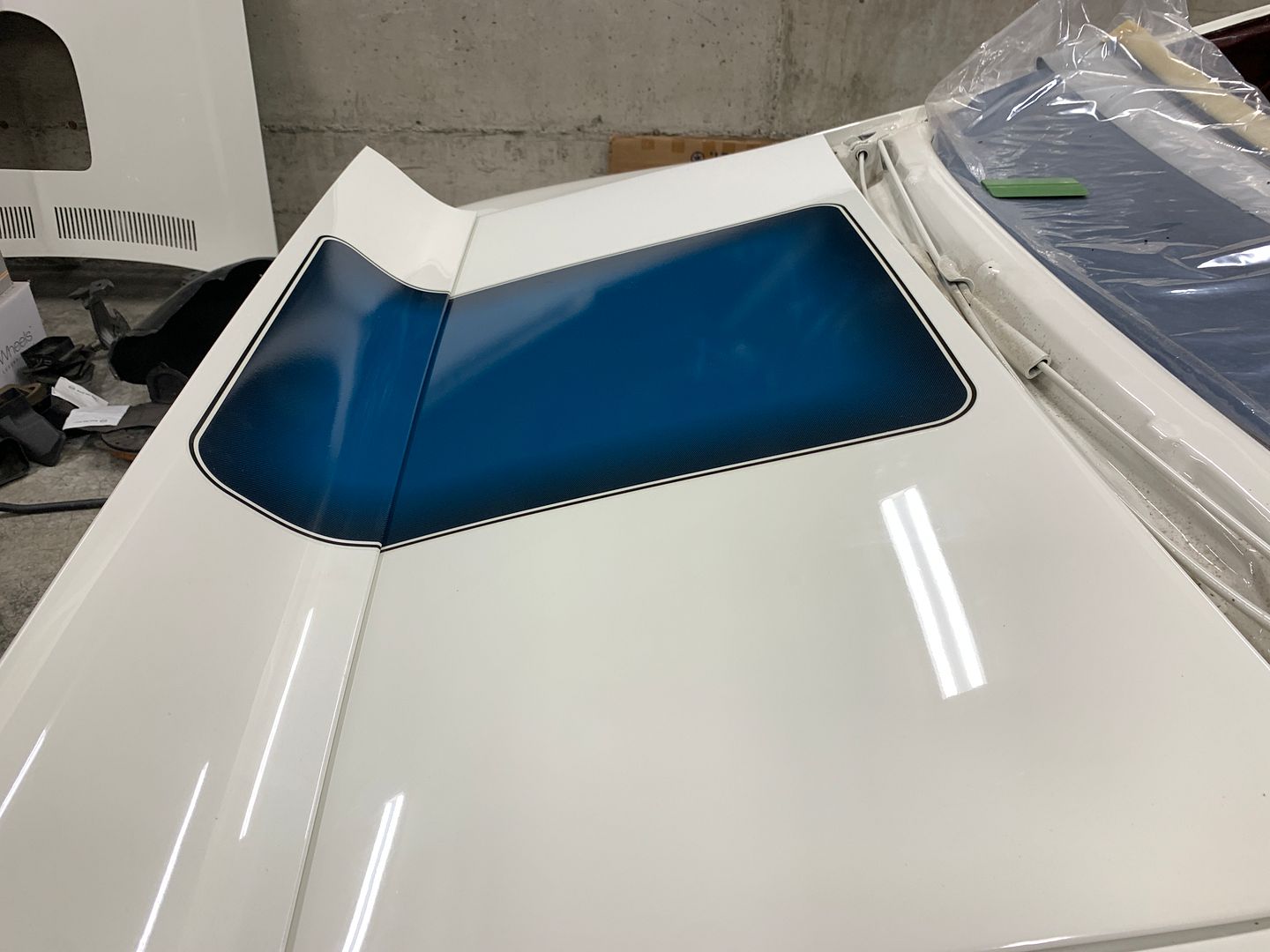

And before anyone says anything the hood has been sitting like that for years and no damage to the paint or bends in the hood.
Lower left corner of that first drawing shows to tuck decals under the spoiler .30 inches - that's what I went with.

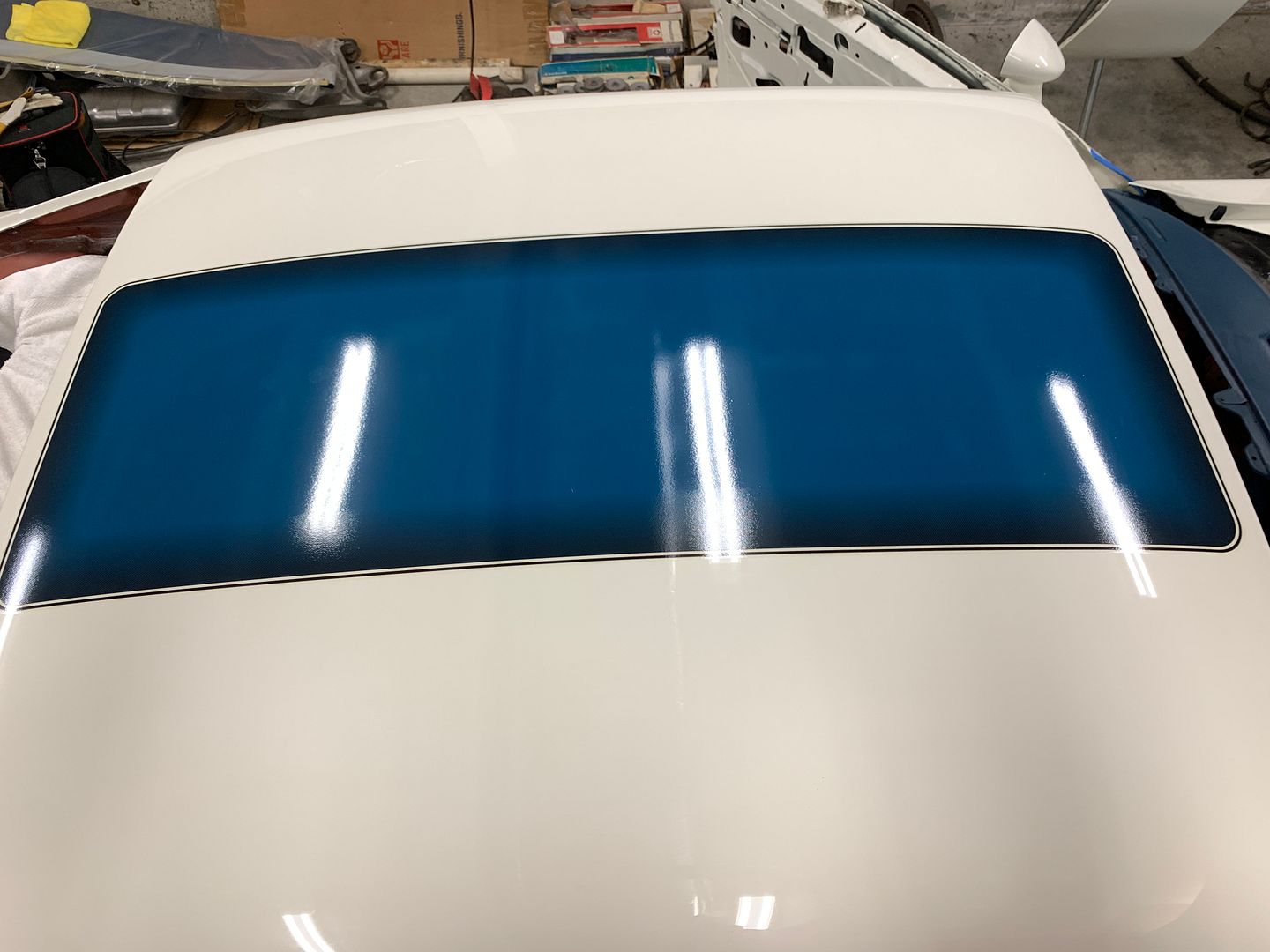

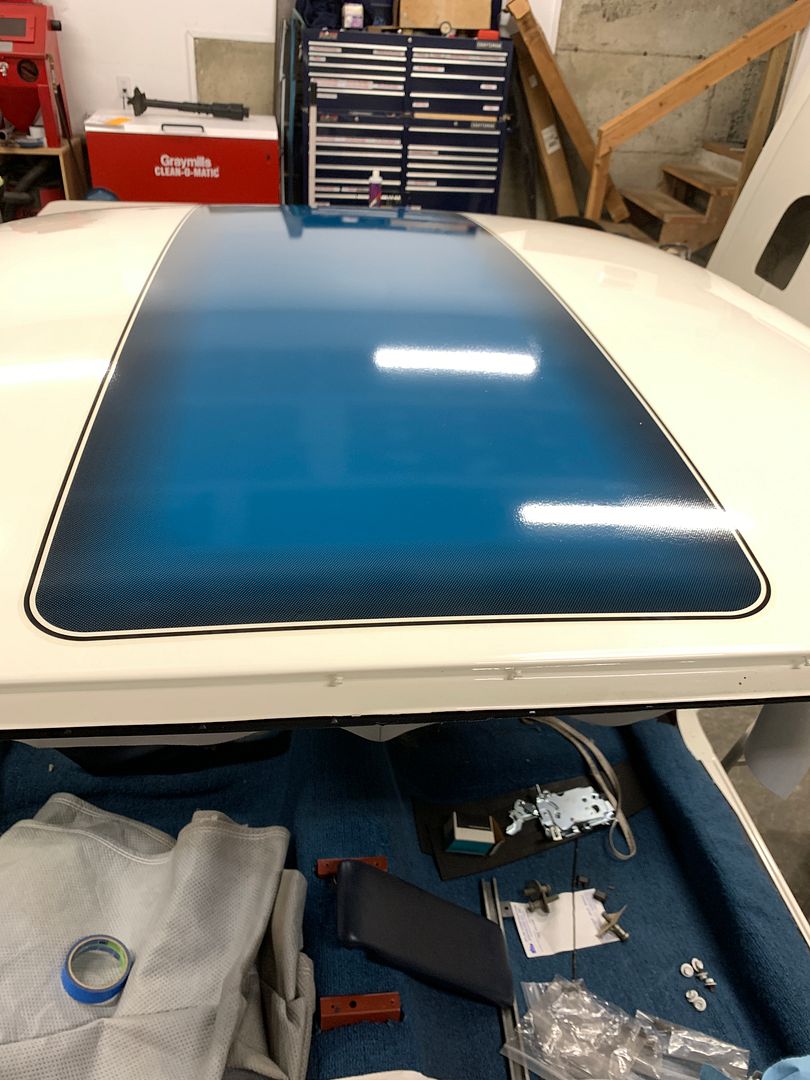

Roof stripe just for a visual.
