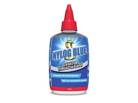

I used the same and it worked well, just be careful that lower tube can spin when trying to install hose. Of course you do not want to crank down on the fitting anyway but when vacuuming down system it was leaking there both times. I finally bought this sealant just to be sure I had no more leaks it is called nylog
Thanks - I actually saw that on Home Depot's website. Glad to know it works, will check it out.
