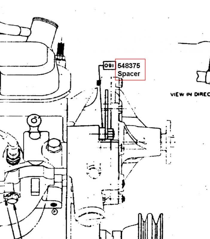

According to the 1967 assembly manual, there is a 548375 spacer between the cover and the hook.
ID:	672839   Click image for larger version

Forgot to mention in initial post that I’m working on a 66 GTO, so maybe no spacer like that illustrated for 67.
