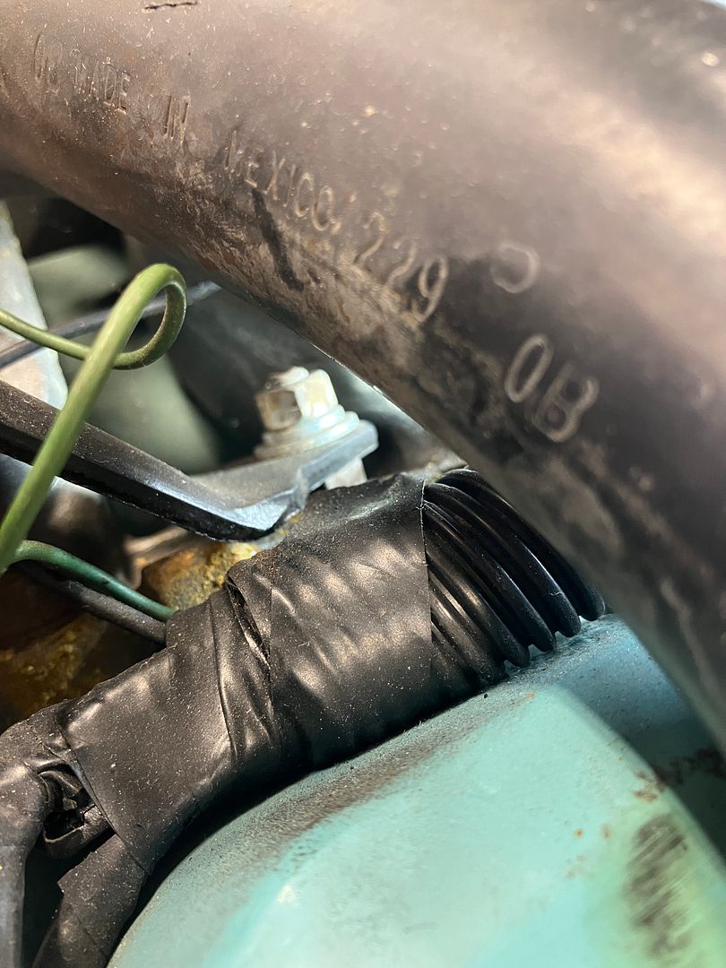

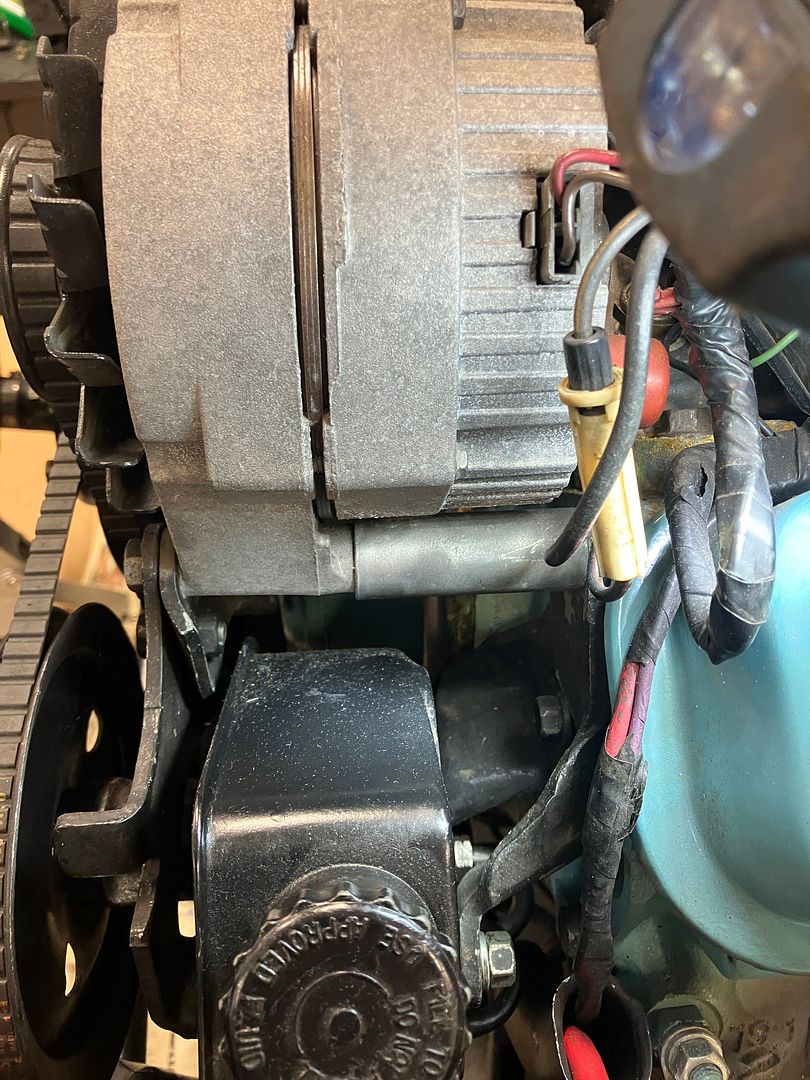

Here are a couple pictures I had on my computer from my 73. I will try to locate some more.

Period, I noted your spacer.. I gotta look that up in the assy manual.. thanks for pics!

Most common '71+ rear alt bracket was used with 71+ 10SI alts like the 927's & 928's.
Less common '71-76 Pontiac alternators were the large case 27SI alternators like '71-73 1101015's and the later "1024"s & "1016"s. This setup required an 80 AMP only rear bracket, & were used on '71-76 Pontiacs with factory AC and Rear De Ice (grid style defroster). This set-up is what we are seeing in PEPI's pic of his F-body's 80 amp Alternator.
Have rear brackets for both styles, stocked fairly deep on all 80 amp Pontiac pieces EXCEPT Idler pulleys & fixed front 80 amp alternator brackets.

Thanks all. Those pics help. I did also notice that spacer on yours.... appreciate it.

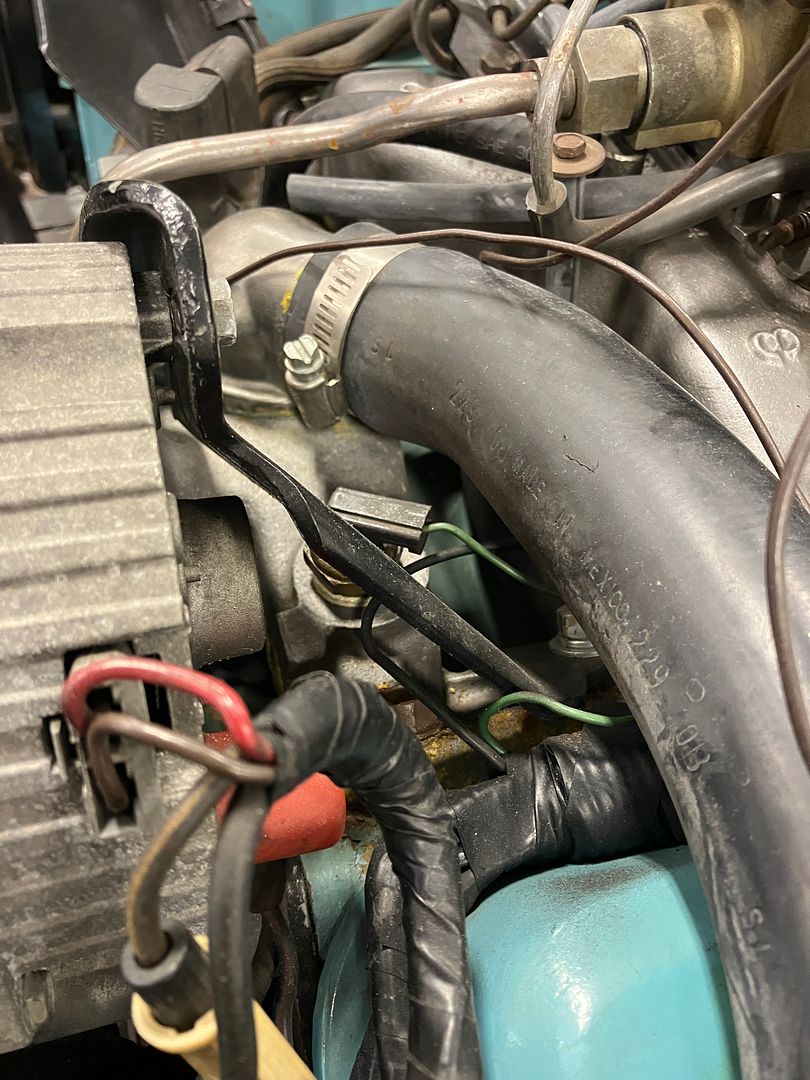

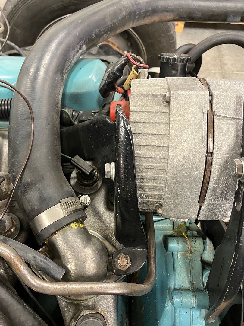

Here's some pics of the alt bracket on my 71 TA 455 HO. Can't swear they are 100% correct but they look it to me. No spacers between bracket and alternator on mine.
John

I noticed your bracket is bent towards the alternator whereas mine is bent away from it, thus requiring the spacer. Item 19. According to this it is for 71-74.

I see that on the drawing. I may very well be missing the spacer and someone may have just tightened the bolt up without the spacer, probably using a shorter bolt than original.
