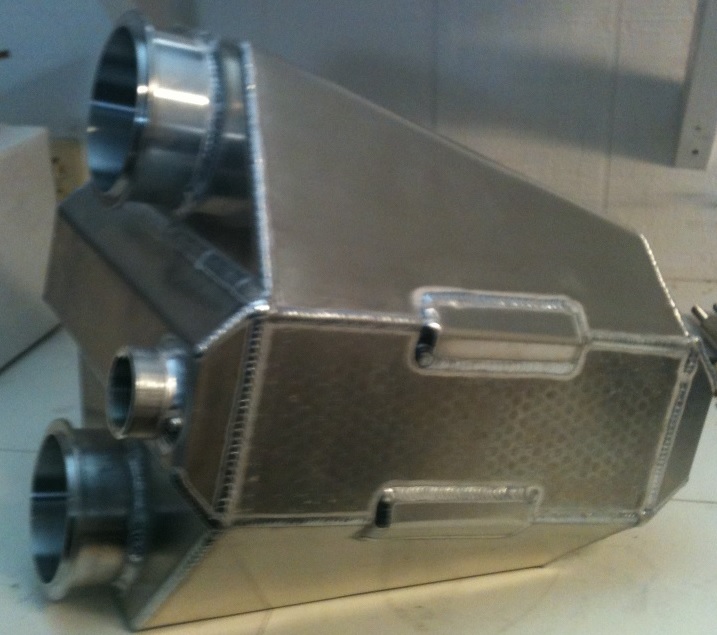

Intercooler acquired.

cgeise cgeise is offline
Location: Ellensburg,WA
Posts: 2,944
dem bitches be heavy

Posts: 1,346
Shipping weight 41.9 lbs, I hope it's being shipped in a lead lined box!

Posts: 2,944
No lead -- they are heavy and there's no water in it yet - add a tank and water pump and 5-7 gallons of ice water and add another 55 to 60 lbs - ask me how I know -- lol

Yep, your Water to Air intercooler deal can easily add over 100 pounds to the vehicle weight (with a 5-8 gal ice reservoir)..
Say you have a basic 5 gallon reservoir. (40 pounds just for the water). (Pint a pound the world around). Then the aluminum or plastic reservoir weighs a few pounds.
Then you have the pump weight and the transfer lines/ water weight. Finally you have your 42 pound inter-cooler before adding a gallon or more to that unit.
But at the end of the day the engine will be able to run more boost without durability issues.
