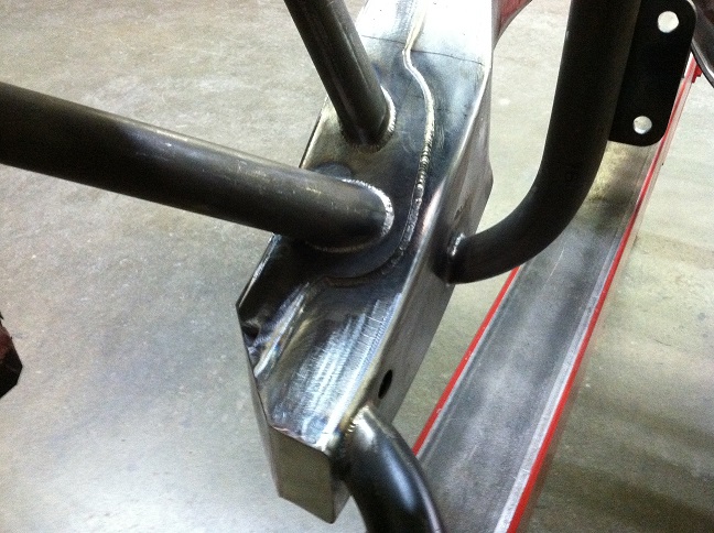

Have your guy put some addition weld on the seams of that subframe, Ed, as it will see a lot of stress (as a drag car) even with the "J-Tubes" welded on.

Hey Tom,
We have the welds on what's left of the factory sub frame cleaned up.

Nice, even a modded frame goes a good way under the car and full seam welding helps.
Looks like you have a good welder. We have some of the best in the Detroit area.
Tom V.

Hey Tom,
Wow - Can "Mike Hall" weld!!!
Looks Real Good!!!
