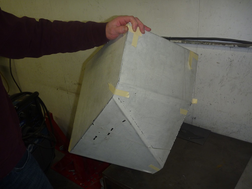

its amazing how close the two halves of the intake match up. length and width look real close
When I get the parts back from the chassis shop, I'll get some better pics for ya.

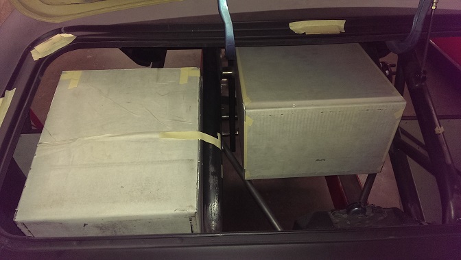

No dyno numbers yet, the engine is back at the chassis shop to finalize the intake and exhaust piping locations.
Harland Sharp Shaft DCI-RA-V Rockers Mock-up.
Ice Chest and one of the Fuel Tanks.
Drivers Side Fuel Tank

2 fuel ranks = street car! Or dually looks great

one pump gas, one race gas / methanol? when you turn it up

You got it, also wanted a little extra capacity available for those longer cruises.

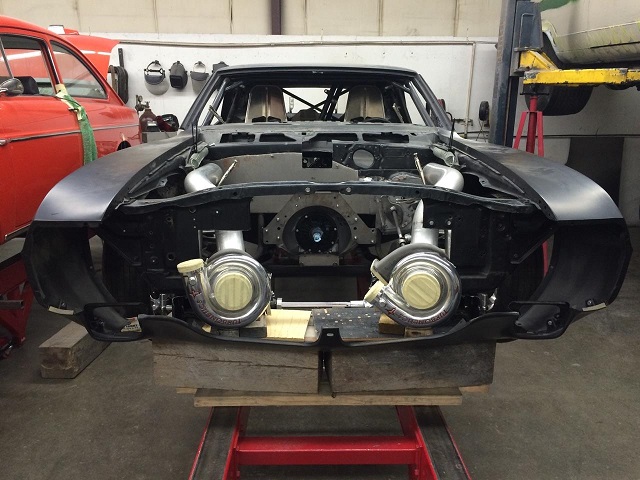

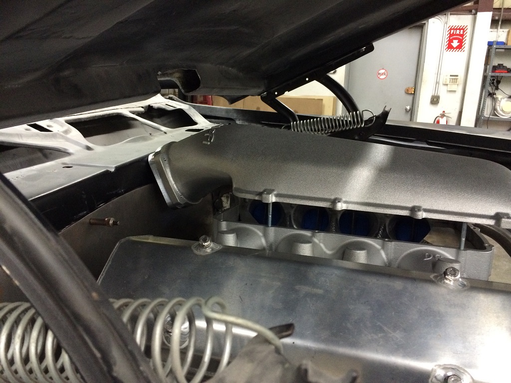

Yeah, progress has been extremely slow over the past few months, I expect the pace will be picking up... On a positive now, the induction system will fit under a stock height 69 Firebird 400 hood. We did move the engine from the stock location a bit.
Luhn Performance is supplying the pieces to attach the DCI Intake bottom to the Holley top.

  #1169
Old 03-05-2016, 06:50 PM
cgeise's Avatar
cgeise cgeise is offline
Location: Ellensburg,WA
Posts: 2,944

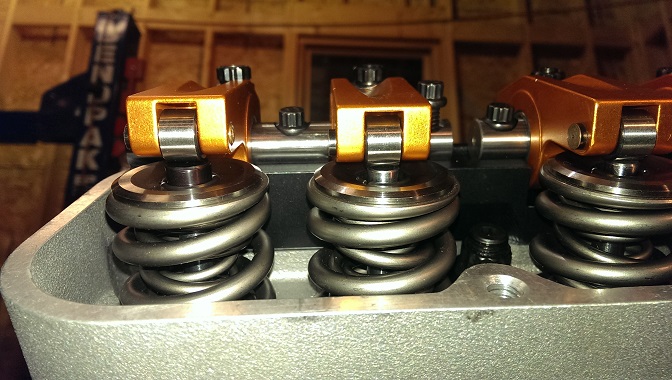

look like pretty hefty valve springs for a street car lol

Old 03-09-2016, 07:51 PM
RAIV-Z's Avatar
RAIV-Z RAIV-Z is offline
Location: NH
Posts: 1,346
~330lbs seat pressure. I do consider the return road a street

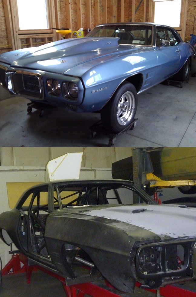

Got any pictures of the car?
Hey Chris,
Before and After Pics.

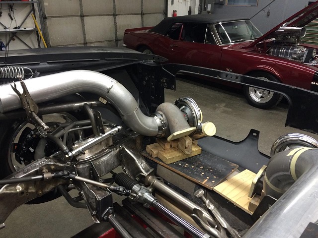

Transitioning from 5" to 4" at the turbo, exhaust will exit near the rear or the doors.

might want to re-think that a bit you will not believe how much heat those put off

Mine will glow at the bend sometimes, I assume it is hot!!! LOL

Appreciate the feedback guys, we'll be exiting the "race" exhaust forward of the front tires.
