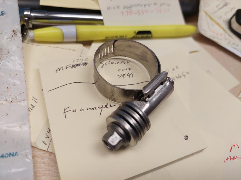

I work on school buses. The last several years of new buses we've gotten (all Freightliners), have these style clamps on everything.
I found out that Napa carries them. I use them on everything. They make them small enough to fit on heater hoses. I recently replaced all the hoses on my 2005 C10 Silverado. 5.3. I replaced all the clamps with these.
They are NOT cheap! But the best clamps I've seen
I wouldn't be surprised if OReillys carries them, or at least could order them. I have a locally owned Napa in my town
I buy most of my stuff from them. They carry great parts like these clamps!

Originally Posted by Schurkey View Post
I really like the SHIELDED Breeze clamps, especially the "Constant Torque" version with the stack of Belleville washers on the tension screw.
Yup, that's them.
