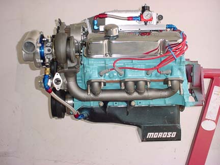

Thanks everyone, I'm glad to see that so many people like my upper radiator hose!
The heads are 7F6's ported by Butler
Pistons have about 10 cc dish for 8.2:1 compression
Injectors are 95 lb/hr
Boost was 18.5 psi
Cam is a custom Comp Cams solid flat tappet, 234 degrees at .050", .500 lift, 114 degree lobe separation, single pattern.
Tom V - The intercooler core is an no-name ebay bar and plate piece, 27" x 6" x 3", intake air temp at the throttle body is 110 F under boost.
Here are some more pics:

Now thats a Sleeper

Nice T/A 455TURBO--Looks factory--Pontiac should have kept the 400 in production in 1980 and put TWIN TURBO'S on it .

That is very impressive!!!
Now lets see......that computes to about 875 at the crank. How much boost are you running?
I have to complement you on the cleanliness and plumbing job. Very nice work.

I especially like the custom-fabbed headers with the head bolt stays that bring the bolt head out past the primaries where you can get a wrench on them.
Very nice work.
Now how do you get that thing to pass the emissions test?

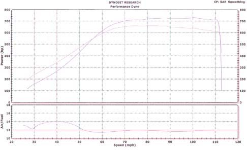

Any chance you could post the dyno sheet?

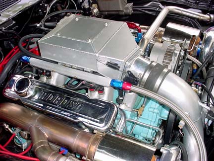

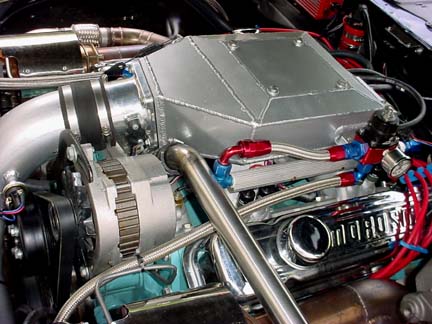

Do you hame some close up pics of the intake section???

Thanks everyone. The trap speed on my 10.58 second pass was 130 mph. That was when I was making only 600 rwhp. I'm hoping to break into the 9's now.
Here's the dyno sheet, sorry, it's scanned. I don't have hp vs. rpm, just speed.

Close up pics for GAS455:

Another
