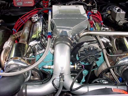

One more

Need to polish out that intake box :P
Looks great...you do all your own welding and stuff ?
Turbo we are getting ready to do an altered version of your exhaust manifolds...Im determined to keep the pwr steering pump in stock location...so inner fenders are coming out and turbo on driver and pass sides will hang out to the sides.
Oh btw where did you get the water pump and crank pulleys for that serp belt?
Mike

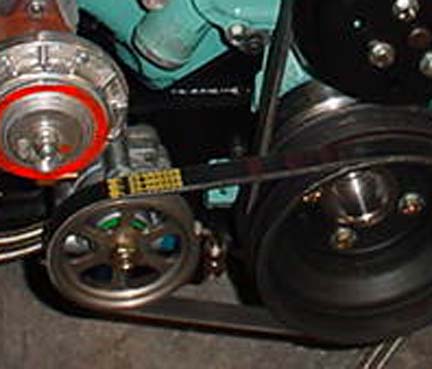

Yup, I do my own welding and stuff. I bought a TIG and a used Bridgeport a few years ago, two of the best investments I've ever made.
The pulleys are from a 5.0 Liter Ford Crown Vic. I bored out the lower pulley and drilled my balancer for the Ford bolt pattern. The water pump pulley had a 2" hole in it, I welded a piece of steel plate in the hole and drilled it to fit the Pontiac water pump. That's a GM CS140 alternator that puts out about 90 amps at idle which is necessary for my cooling fans, fuel pumps, intercooler pump, and fuel injectinon.
Here's a pic that shows my KRC power steering pump on the lower passenger side of the engine. Moving the power steering pump was not a very big deal.
If you think my intake plenum is ugly just wait and see how your engine looks with a big old nasty GM power steering pump up in front! :0

I am interested in the bracket configuration for the Kre Power Steering pump/ bracket on
the passenger side if you would share it with me.
Thanks.

Tom - I wish I had some better pictures of the power steering pump bracket, this is all I have. It's just a piece of 1/4" steel plate that bolts to the two timing chain cover bolts on the passenger side of the engine. I ran a brace back to one of the motor mount bolts in the block and reinforced the plate with a rib. I have slotted holes in the plate for the pump to slide away from the engine block. It doesn't swing like a normal bracket, it just slides. The lower radiator hose is a tight fit. The bracket requires a small diameter aftermarket balancer so that you can get to the bolts. I hope this helps your turbo kit, when did you say it would be available?
69v8tr6 - That pull stopped around 5500 rpm. I have the rev limiter set at 6200, and it pulls hard all the way there. My cam is 234 degrees at .050" It's custom ground by Comp Cams I can find the part number if you want it.
