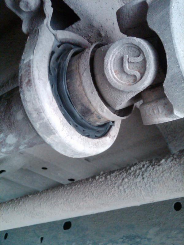

check out how ford engineers redesigned the hanger bearing on their new trucks. this is a 2009 with 90000kms(55000miles) . not serviceable and not available seperate from ford. local ford dealer wants $1400.00 for a new shaft that only needs a $75.00 hanger bearing. actually the bearing is fine, just the rubber mounting is wrecked. to get the guy on the road for now we welded tabs from the hanger bearing housing to the outer bearing race basically eliminating the rubber from the equasion.
also instead of that sticker on the driveshaft they should have one on the dash. SCRAP IF THIS TRUCK MAKES IT OFF WARRANTY

Don't you have drive shaft shops up there? I can go to St Paul to CATCO and have ANY drive shaft repaired or made from scratch.

Looks to me like the shaft was out of balance,trans mount broke or the slip joint froze up from lack of grease.
Those are the common causes of hanger bearing rubber getting chewed up.

typical. this is what i hate about fords. their engineering dept is ****ed.

never thought i'd have to order in a driveshaft to fix a 50 dollar hanger bearing
. thank you ford for bringing me back to reality
